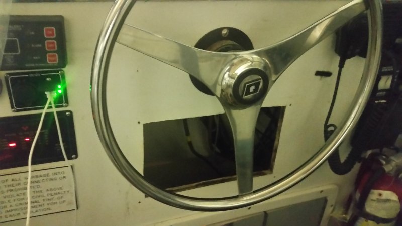

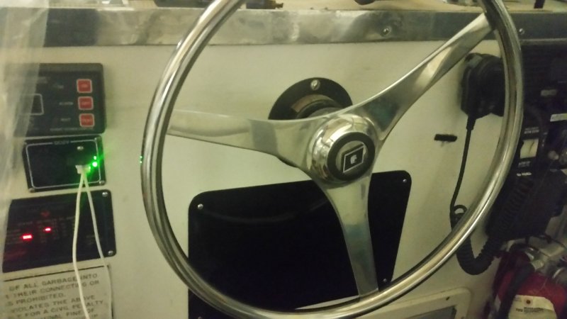

A few years ago I had to do work to my helm on my 10 meter Express and I thought the access was ridiculous. Enclosed are the pictures of my solution. I cut an opening with an oscillator tool and installed a simple smoked plexiglass cover that matches the sliding cabin door. . Mnimal costuch improved access and a lot easier to fish wires thru.

cool idea
what did you do to seal the balsa core?
