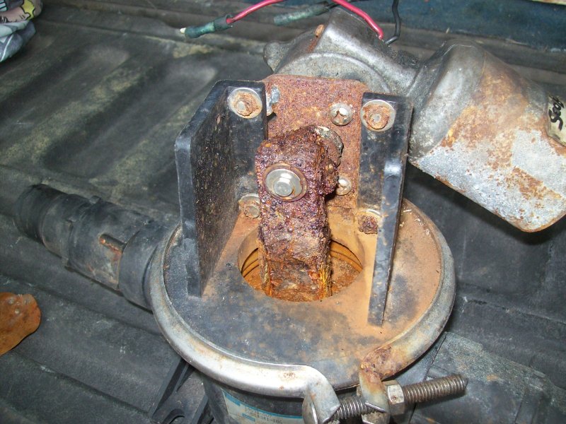

Got the vacu-flush pump out today. Picture attached. Looks pretty rough to consider rebuild. Don't know about Vacu tank.
Toilet does not seal and hold water.

Re: Changing toilet system from vaccuflush???
I believe it came std with Vacuflush bit not sure . Not sure about the head it self on rebuilding bit the rest is junk and needs replacement

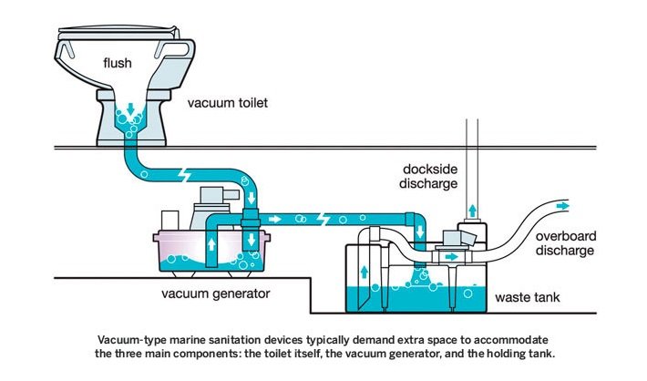

If my vacu-flush broke, I would pay whatever it would cost... to replace the whole system with a brand new .... vacu-flush.
Vacuflush System.jpg (39.36 KiB) Viewed 13213 times
