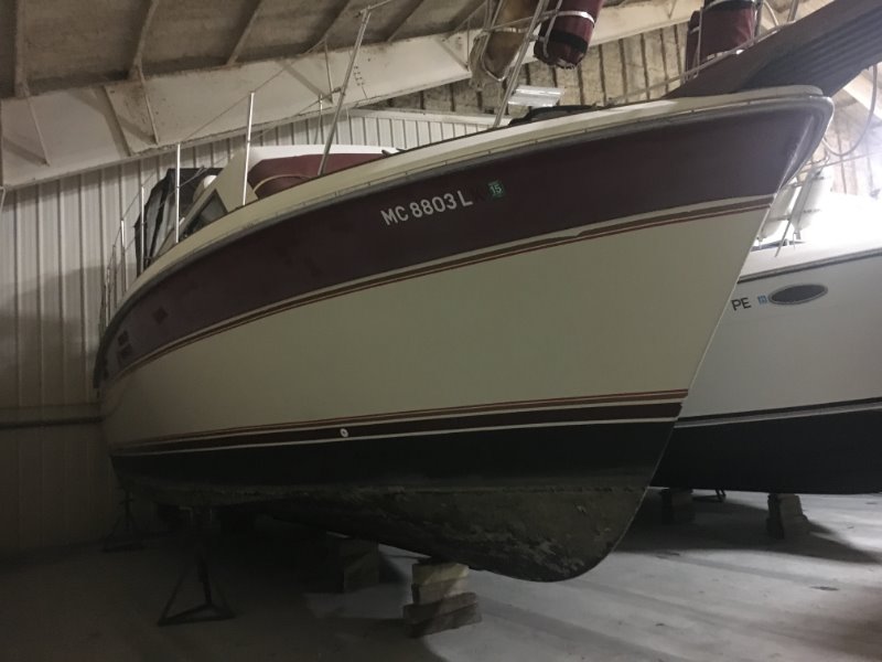

Looking for input on common issues on a 36 foot trojan tri (364) . A friend of mine has offered me this boat at a great price including slip for the summer . Its definitely a fixer upper which im ok with, but I want to understand what im getting into. I have no experience with a boat this big or inboards , but I am an auto mechanic by trade and not afraid of fixing things. I spent about 3 hours today crawling through it and here's what I know for sure . Port engine block is cracked and repaired with marine epoxy looks like freeze damage . It has been operating like this for several seasons without issues per owner . its a 260 hp chevy . I would plan on replacing the block and have talked with marina about crane service in/out . I can see I would have to remove salon floor , kitchen area, and salon roof access panel . would like any input on what this might entail that may not be obvious to me yet . Looks like bottom of water heater below forward salon floor is rusted and may be an issue. one of my big questions is , Does the transom have a wood core on this model ? it has a strange sound to me when tapping it and if it were an inboard/ outboard I would think its rotted, but since its an inboard im not sure of transom construction . It has a soft spot on the starboard side deck towards the front , can see it was leaking at the bow rail mounting and has been sealed , minor water damage /marks in front v berth. Also minor water damage on aft cabin starboard side looks like from cabin side window. owner has this area disassembled in attempt to seal and claims its fixed. Needs general tlc and clean up but owner has been pretty good about mechanical maintenance , all new water hoses , plugs ,wires, belts etc in the engine compartment.. Reputable marina has done maintenance for several years and they seem pretty familiar with this boat and owner because he has been good about mechanical upkeep.
would appreciate any input / advice I can get as I know im about to dive in over my head and im probably too dumb to realize how deep.

Dunno what the deal is with the transom, but it is not cored -- on those boats, nothing below the rub rail is.
As for the water heater, if you shop very carefully you can find a 19 or 20 gallon water heater that will fit through a door. The problem will be getting the old one out. I had to remove the outer shell and insulation to get it out of tbe cabin door. Of course, if you pop the top to change engines, that would be the time to change the water heater.
These boats are easy to work on. You can search my posts for fresh water tank install and underwater exhaust replacement for some advice on tasks that yku might face.
And ill pass along my standard advice. Run down to your local bookstore or ISP and get yourself a copy of nigel calder's boatowners mechanical and electrical handbook.
Welcome to the forum. Pics always welcome.
