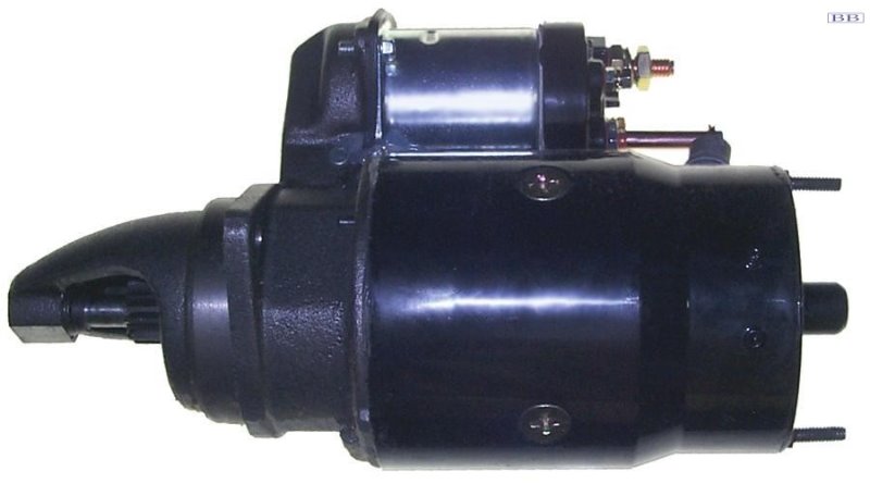

Fords use Both types . My F30 used both types . Anyway my thoughts on the starter mounted solenoid also apply to the external style .
I posted 3 photos below . From one post I would think you had a solenoid on the starter as you said you may have wired it wrong ( the other is only one wire so'......) and from this post I would think not . The one with a built on sol. can also have the external relay .
wo/ sol
wo/ sol
ford marine stater 2.jpg (10.04 KiB) Viewed 10659 times
w/sol
w/sol
ford marine stater 1.jpg (12.51 KiB) Viewed 10659 times
used with both Ford and GM bell housing mount
Merc marine starter rev turn reverse mont.jpg (37.18 KiB) Viewed 10659 times
