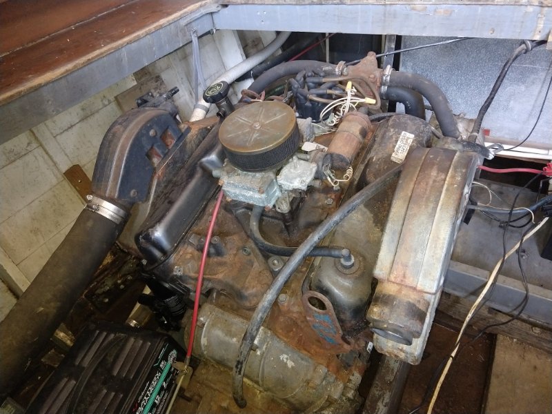

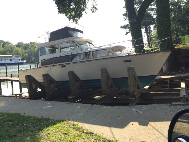

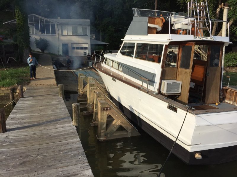

Here are some photos
On one engine.
On one engine.
Today
Today
4yrs ago
4yrs ago
4yrs ago
4yrs ago
4yrs ago
4yrs ago

Someone put an AC in and switch one door to hinges... Hurts my soul.
The goals is to just have something to putt around the river with maybe an overnighter on the water here and there.

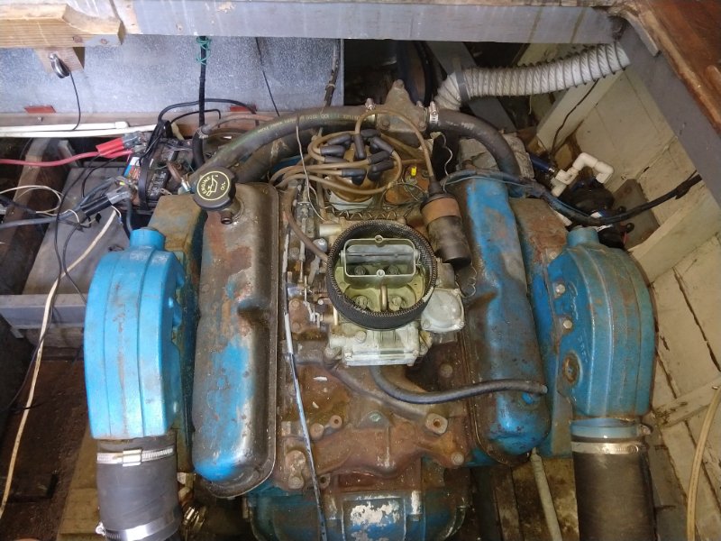

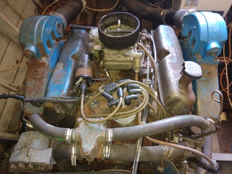

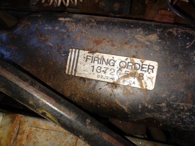

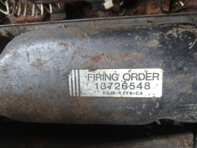

Here are some more photos of the engine. I know they are ford Windsor heads. Not sure if that's 351 or 302 though.

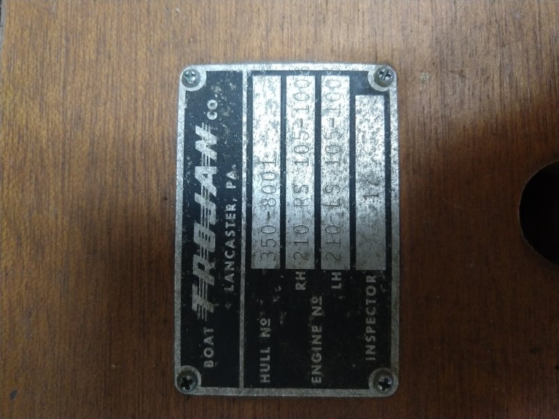

I'm getting desperate on finding an ignition wiring diagram. The coil wiring seems butchered, I see no resistor, no spark with any method I try, also my bendix gear keeps getting stuck when engaged but that may be improper shimming? I'm pretty sure I can find a diagram in one of the manuals provided on this site. I just need to know specifically what engine I'm working with. I've provided various numbers I've found on the engine in the picture.
Thank you guys so much. The James River is calling my name.
Re: New member/owner

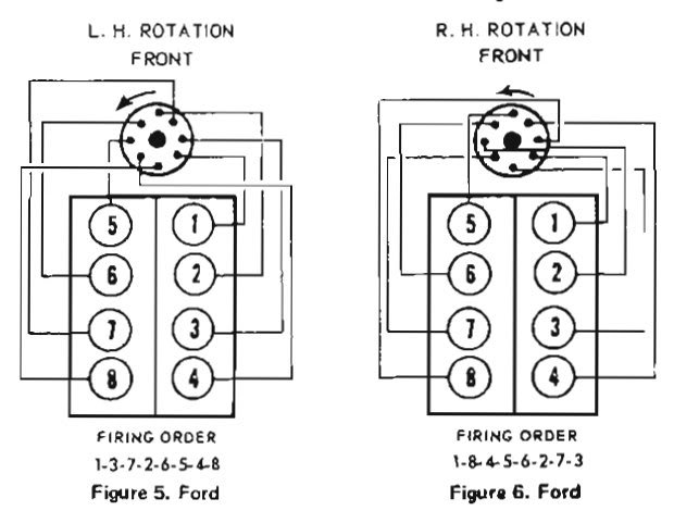

If the valve cover came on the engine you likely have a 351 per the firing order and they look wide some I am betting on 351w
ford marine fireing order.jpg (49.24 KiB) Viewed 4996 times
Post by Captrichc »
That is definitely a ford. The distributor is forward on the engine.
