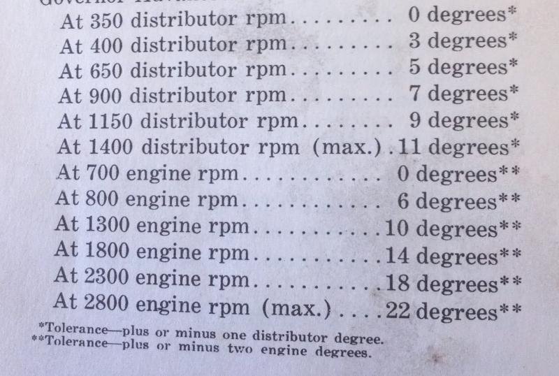

I used these numbers on my 318 after posting the same question, with what seems to be a mystery. I'm at 7deg initial, so 30 total all in at 3000 or so, I'm on step about 2300- 2500. You don't want full advance at that load. I was able to use springs from a Mr gasket hei kit. The prestolite replacement springs are sitting next to the holy grail somewhere. And instead of a limit bushing, I used a tach weld and a file. I had that distributer apart ALOT. but after all that the boat runs great.

Marineengine.com, there are a lot of Marinette owners that have Chryslers. Search fast Jeff, grab some popcorn, you'll be busy reading. These timing numbers were from a 440 service manual I found on that site

1981 F-32 318-Cid The timing chart shown is right on. I currently set the initial timing at 6 degrees at 700 rpm. Had the distributor dialed in on a distributor machine to 30 degrees total. Remember to take into account the type ( octane ) of fuel used and the weight of the boat loaded.

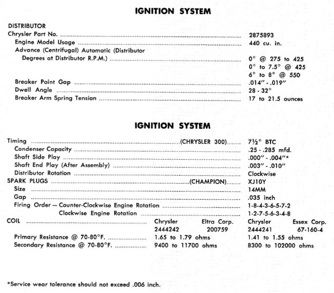

I have never been able to find a service manual for the 330 HP Chrysler Marine 440 cu in engine. The manual I have been working with is for the 300 HP version and has the following ignition information:
440-300 Ignition Specs.jpg (83.18 KiB) Viewed 11861 times
Interestingly, MarineEngine.com sells this manual as the correct one for the M440/330HP as well. I had seen the numbers that 44Ydnar88 posted and am going to use a base of 5-7 degrees and total advance of 28-30 degrees if I cannot find anything more appropriate. From what I have been researching, you really don't want to go over 30 degrees on this engine.

WayWeGo wrote: Mon Mar 25, 2019 12:32 pm I have never been able to find a service manual for the 330 HP Chrysler Marine 440 cu in engine. The manual I have been working with is for the 300 HP version and has the following ignition information:
Completely agree with this but I would keep it to 28 max as a total and add that getting the correct curve is more important than the total itself. The rpm those degrees come in at is the deciding factor in avoiding damaging knock. With the older mallory marine distributors you could use the mopar performance advance kit( springs and degree spacers ) to get the right curve,double checked with timing tape and light.
Honestly with the lack of distributor machines around etc I might be tempted to buy new distributors, cheaper than engines Imo.
