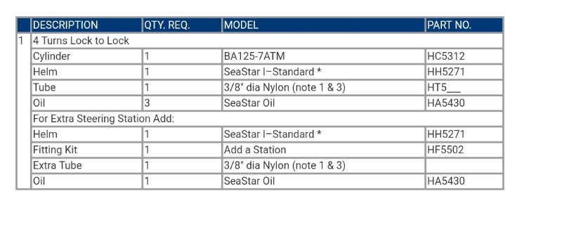

Seastar part numbers:
Helm pumps HH5271-3
Ram HC5312-3 model BA125
The ram model number depends on boat size, single or twin engine, planing or displacement hull, and whether pleasure craft or working vessel http://www.seastarsolutions.com/product ... w/seastar/ but that model number is good for a F32.
Parts cost me about $1K per pump and $900 for the ram, in $CDN, and that is probably MSRP. In $USD you will probably pay 30% less than that, and if you are just buying parts to do the job yourself you may find some deals, like this one https://www.seatechmarineproducts.com/s ... inder.html
Re: Hydraulic steering
Yes that should work . Make sure that 7" travel of the ram is what you need . You will notice that is 4 turns lock to lock The other options 2 & 3 with the BA135 and BA150 are 5 and 6 turns lock to lock . The more turns the easier it is to turn , But of course it takes more turns to get the same results in turning . Just something to think about just make sure 7" travel is what you need .
Update my F36 has 9" travel but may have longer tillers arms then the 32 . Like I said be sure .

Measure where the cylinder will bolt up at form full port to full starboard ( steering lock to lock ) . It looks like captainmaniac Used the same cylinder you picked so I expect it to be the right one . He knows what he is doing and would not picked it with out checking .
