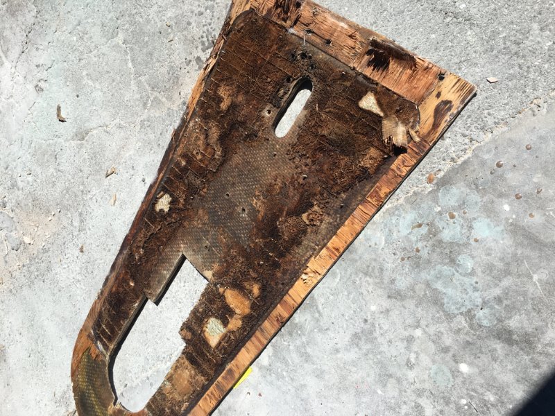

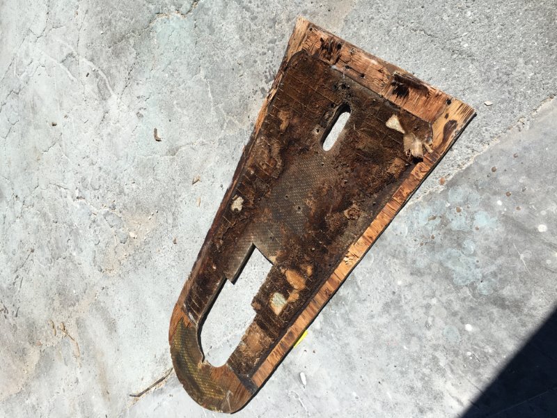

During this years refitment, while I was replacing the water soaked balsa, I upgraded to the GOOD freefall windlass.

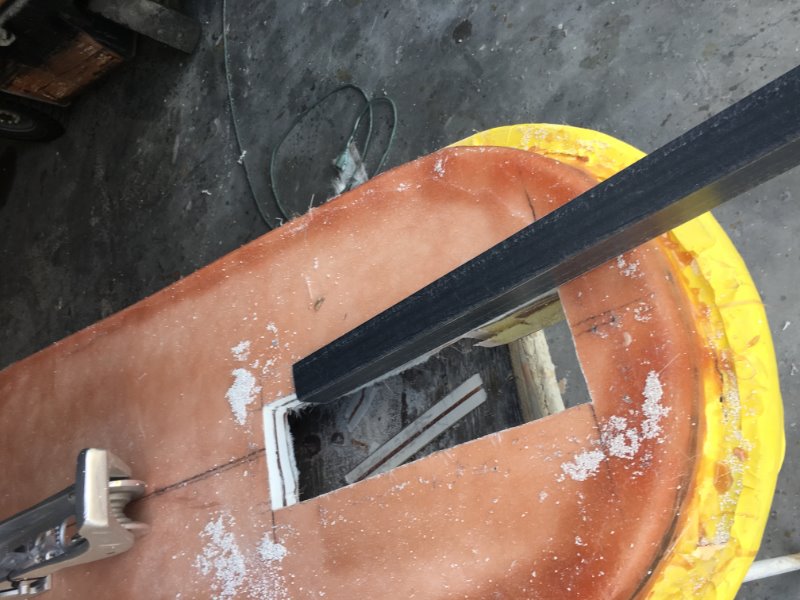

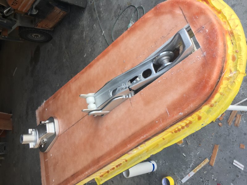

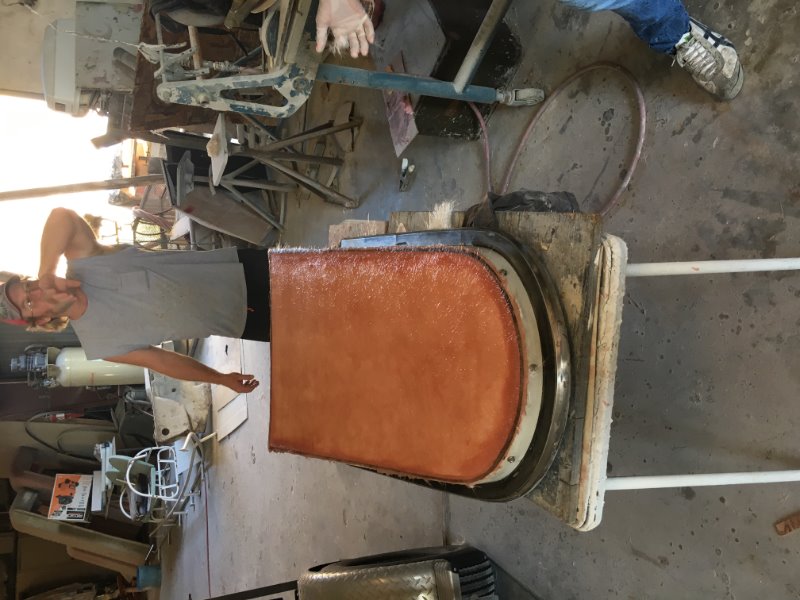

Re: Windlass for 10 meter

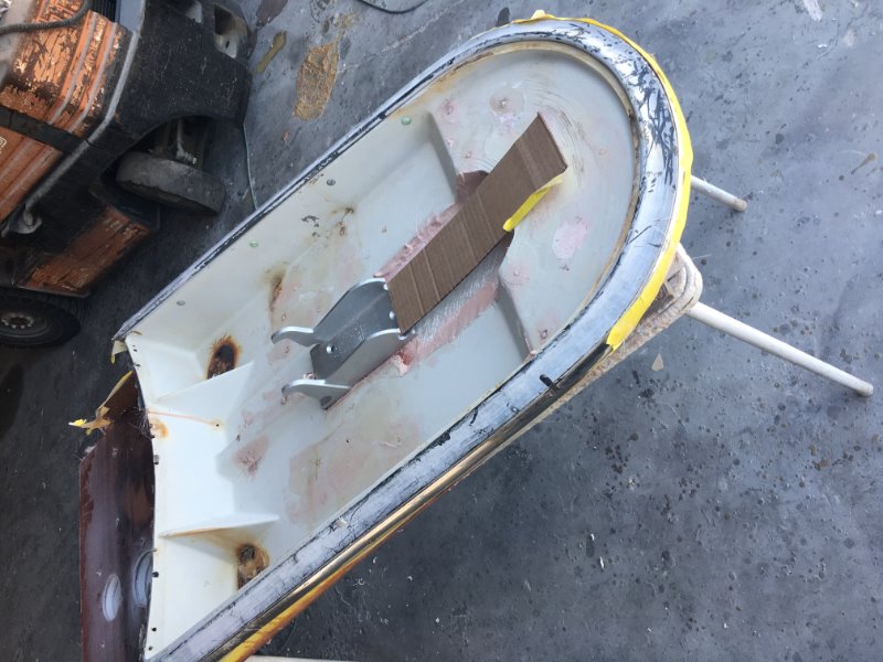

more photos here:

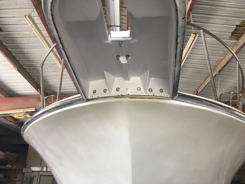

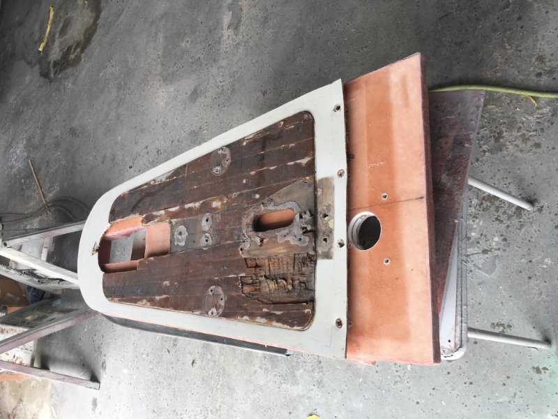

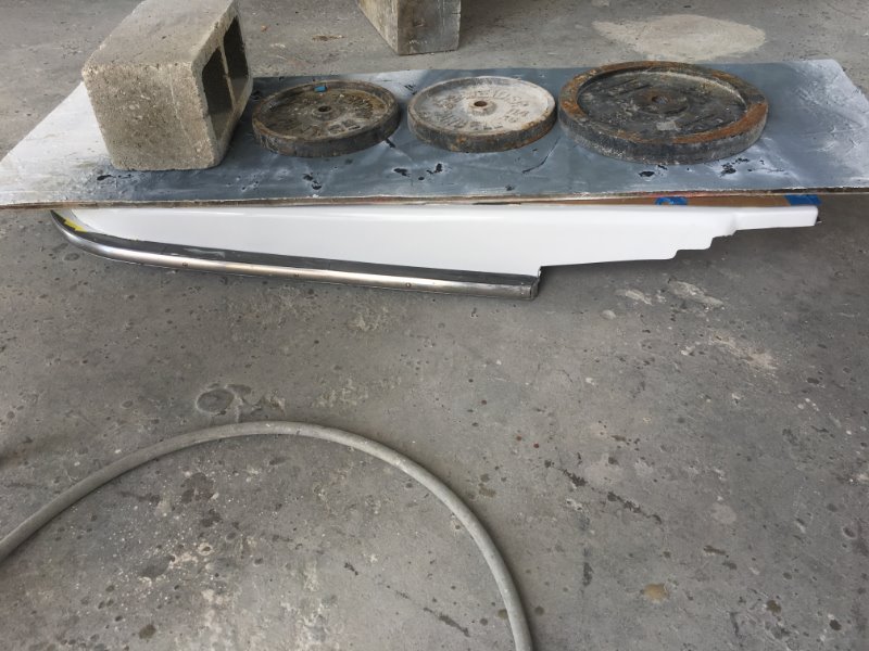

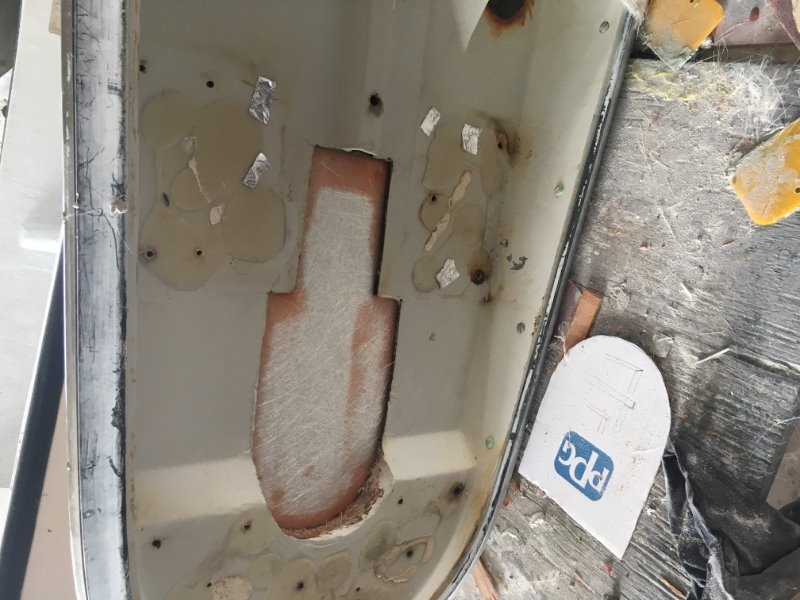

and a few more:

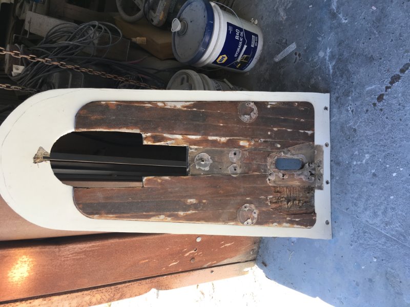

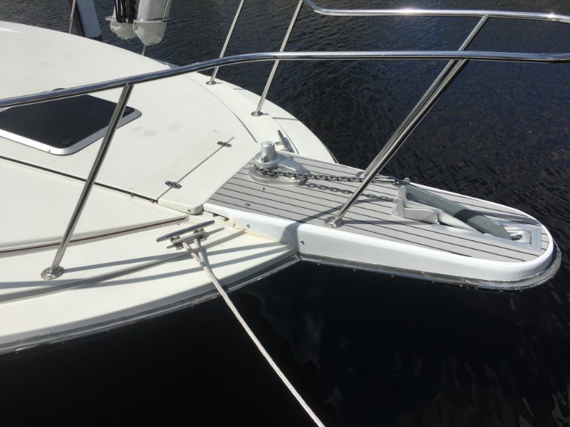

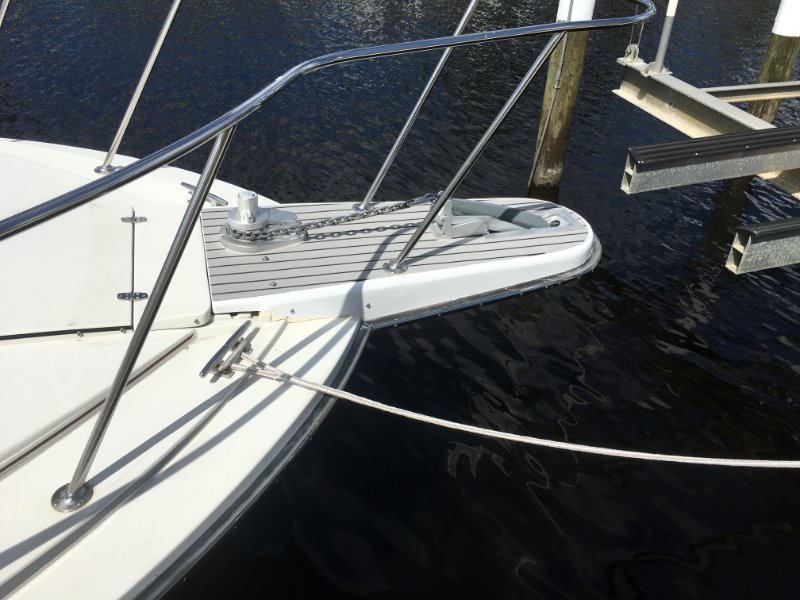

It should be noted that we extended the bow pulpit a bit to the rear, shortening the door to the rode locker.
This was done to INSURE that the rode would be dumped as close as we could get to the deepest part of the locker
I'll get some finished photos taken this weekend and will post

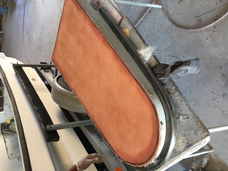

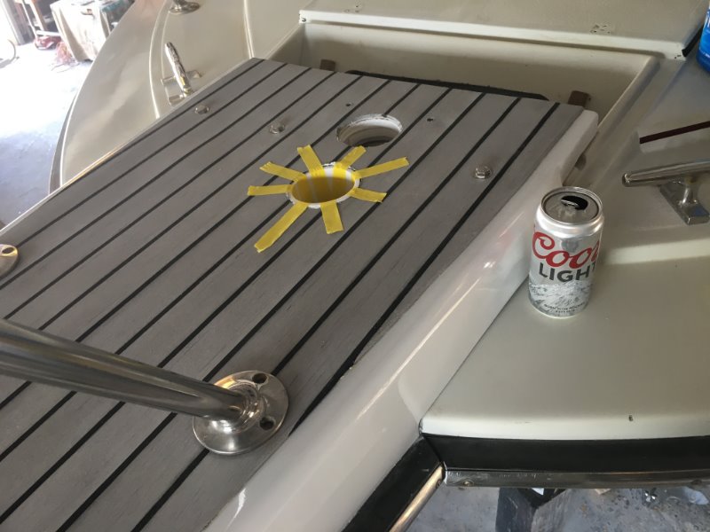

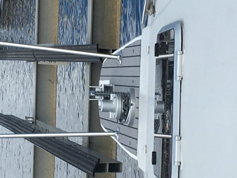

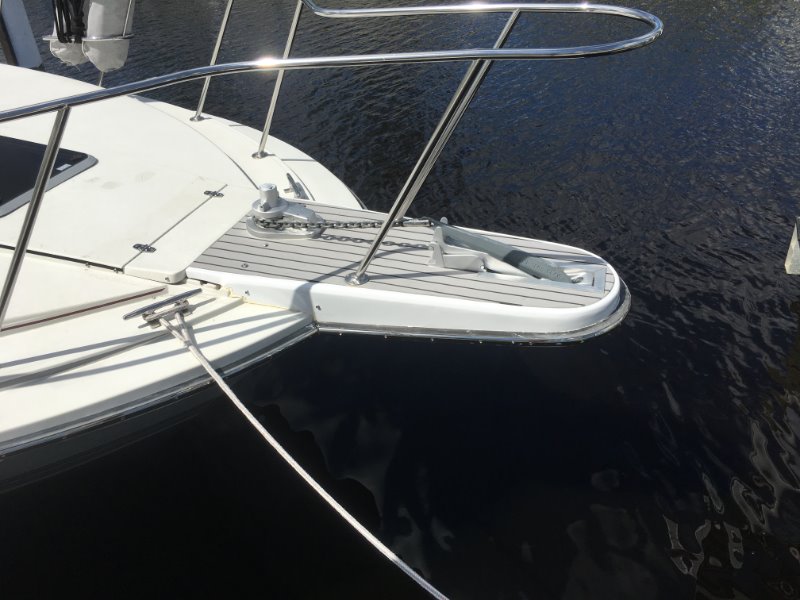

additional photos

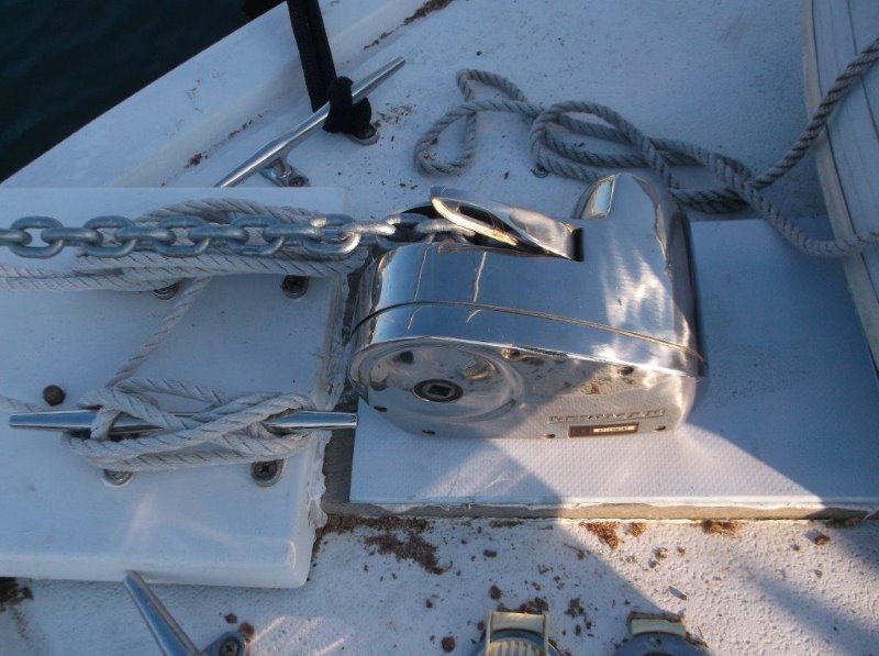

Very nice . I really like that Good rode/chain windlass . I had a Good rope only that worked great at 38 years old . But I wanted to also use chain . So I went with a Lemar pro 1000 due to cost . It was not a free fall but the price was right and you can convert it to free fall ( the pro fish is) . Well the power down is so fast , I have no plans to do so , in fact is seems faster then the free fall I had . I am very happy with it . With that said The Good is a better Windlass and I would have gone with it but the price was right on this one . one year old .
- new windlass.jpg 1.jpg (85.97 KiB) Viewed 13998 times

Another vote for the Good. I installed the same one as RWS, even the same bow roller, worked flawlessly, nice equipment, quality parts, very nice family business to buy from and made in the US. Would not hesitate to buy again.
