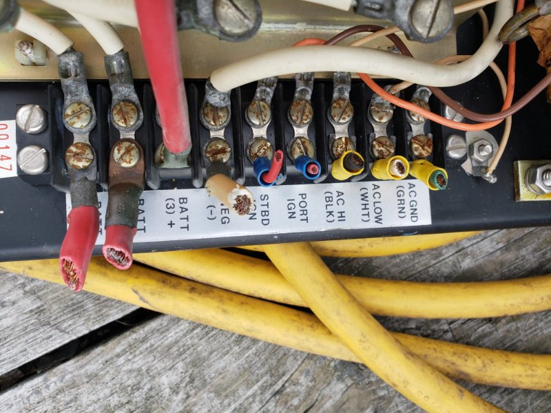

I have the batteries wired from charger. Where to the ignition wires go now? There are no terminals for them on new charger.

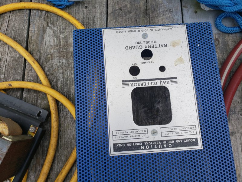

You normaly do not hook up ignition wires to the charger . Can you post photo of the old charge and maybe the wires ?

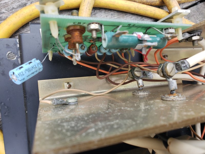

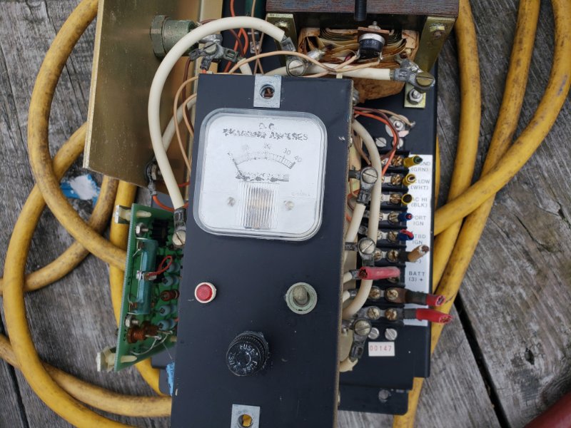

What did you do with the ignition wires after changing out the charger? I just installed the same pro smart. Boat will not turn over just get the alarms.
I believe you are correct about ignition wires killing charger, I traced where they went in old charger and they went to a circuit board only.
Prowler,
Does that help knowing the wires went to a circuit board in charger? Almost time to puller her for the season so I need it running. Thanks for the help.
