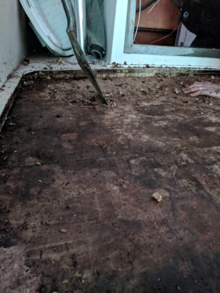

Pulled the boat and winterized. Had an impulse to start the re-core project on my fly bridge floor. Thought I would find the first layer pretty soggy but found that both layers of core were bad. Should be fun! :mrgreen:
Photo is after digging out both layers in a 4 x 8 section. Think I will use Tricel instead of foam or wood. Anyone with good or bad to say about Tricel, please do. Plan on Calling Bob in the am.

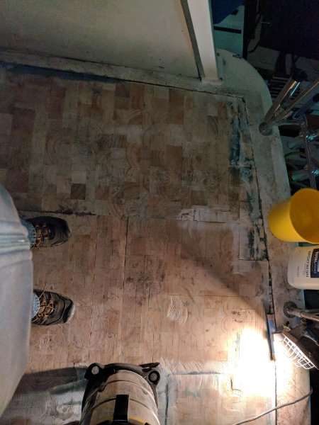

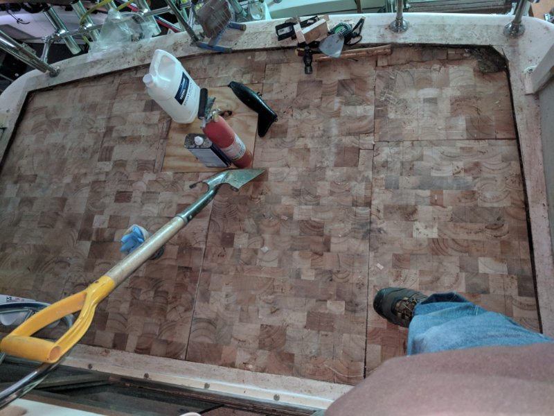

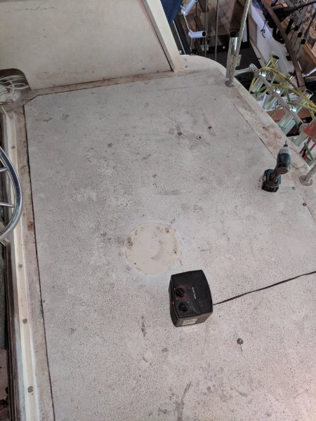

Finally spent the last week putting new core in the fly bridge.
Decided on using Balsa after a few conversations with Bob, Thanks Bob!!!
First pic is first 1" core layer going in.
Then .125 Mat layer glassed in over that.
Then additional 3/4" layer of balsa, which I smoothed with thickened Epoxy before laying original skin back down
Other than fighting the less than 50 degree weather, it went well. Used total boat 5:1 epoxy with good results
Didn't snap a pic after grinding and glassing the top skin, all I have left is to fair and paint.

It was a fun learning process, but a bugger of a project. Resin was taking 2 and 3x as long to kick with the temps. Had to go a little heavy on the catalyst the first part of the week.
The cut lines were ground and a mat layer glasses in to avoid print through. Plan is to sand then fair that, followed by a coat of Interdeck (interlux) non skid. Already had a coat of that up there, so going with another.
WayweGo, I did cut it in one piece. I was not easy to get out, but better than several pieces to work with. Spend considerable time grinding it smooth before laying it back down.
This project scared me before I did it, looking back it was not as bad as I feared. Although I have about 60 hours into it, mostly because of weather.
