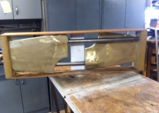

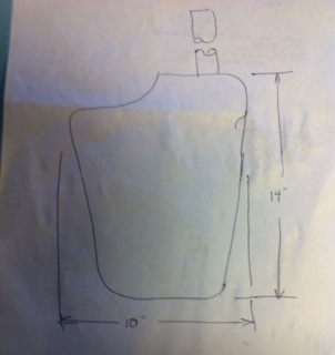

7. Up to around 1974 Trojan used the rudders Paul Foster posted above with a bronze shank.
Trojan changed the Rudder to a smaller size because of problem with the shaft bending.
Around 1992 John Leed redesigned the pre 1974 rudder with a S/S shank.
This is rudder we sell today for a replacement rudder on a F-32.
