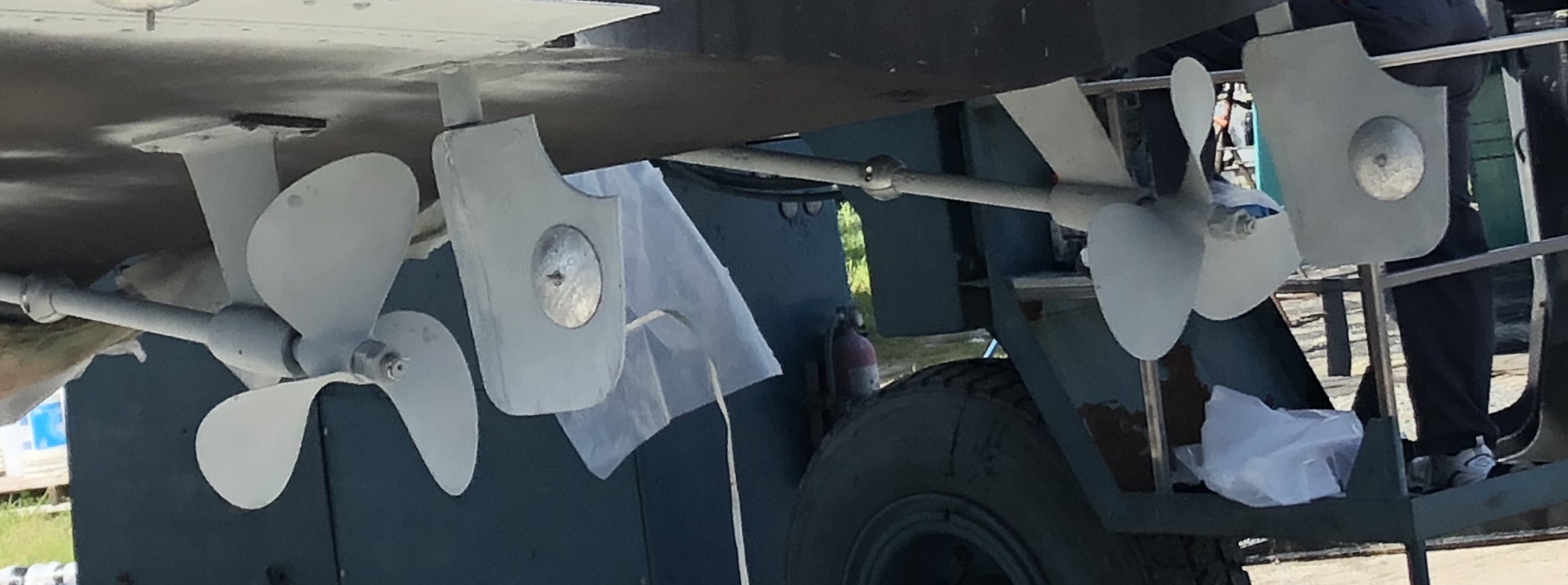

Did you happen to see the size on your props ? Both engines sound the same ?
Re: Not able to reach top end on F32
Unfortunately, I didn’t get a chance to pull off the props before I launched it back into the water last week. I will check this weekend to see if my paperwork shows anything.
- F8ADE6BF-3DF6-4B8F-A877-BC745627AA5B.jpeg (359.27 KiB) Viewed 10328 times

The speed is about right for those RPMs (at least what I get with my 16x16 cupped props), so probably not a case of drag and you likely have the right props if you match the normal speed curve.
Start with the easy stuff first... Are throttle detents or cable length keeping you from pushing to true full wide open? Are distributors properly advancing as RPMs climb? Do the engines sound or feel bogged down or do they seem to be running well? Any plugged tank vents?

Would be good to know the prop size . Check you tachs ( I have a photo tach you can use) . make sure the 4 barrels are opening and the carb linkage for full travel . try using the trim tabs too. Knocking off some pitch can help get the engine up in its power band and get more rpm and speed at wot .

Hope the numbers are good and its some thing easier (and cheap ). One reason I said reducing pitch a liltle , it helps engines that are tired and boats that are hevier ( the way we add stuff) hit the needed rpm . Trojan and others propped their boats with fresh engines and light on toys and oh ya real gas

That may explain those small wheels I have...
