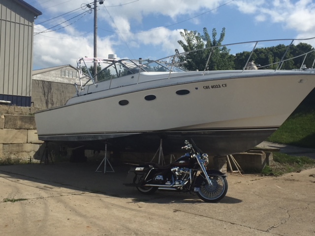

It's true, no structural wood in the engine room liner and stringers. And the Hull is mint!!!
IMG_1678 (2).JPG (107.09 KiB) Viewed 9096 times
