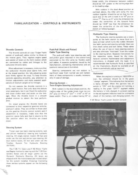

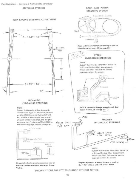

The manual I have is actually a 'generic' 1979 manual, covering the basics for all models. I have scanned the 2 pages related to steering and steering adjustment. Here are links :
I sized the images for 1024x768 resolution - good for looking at online, but not sure how well they might (might not) scale to print. This is my first attempt at using photobucket... hopefully I posted to photobucket correctly, and these links work ! If not, PM me with your direct email address and I can send the jpg files that way.
(Ignore the stuff that is circled on the pages - previous owner marked the manual up to highlight which version of the hydraulic steering was in the boat).
To adjust toe in/out, the other posts re adjusting the length of the connecting bar between the tiller arms are correct (at least on an F32). The bar is threaded on both ends, so twisting one way will toe the rudders out, the other way will toe them in. In my case, the rudders are a bit off thanks to a previous owner (or service person) who used the bar as a convenient 'step' climbing in and out of the bilge area, so it's kinda bent, causing a bit more toe-in on the tiller arms / toe-out on the rudders than there should be. Worst case, if things are WAY off and there just isn't enough adjustment, you might be able to replace the bar with a custom job cut to exactly the right length etc...
