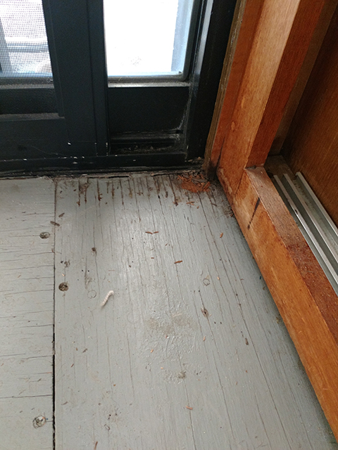

I just go this F32 in the fall and I discovered this soft floor board.
Any suggestions where the water is coming form?
[attachment=0]

Look around the rear glass and frame and the side glass
Re: 1980 F32 salon floor slightly rotted and soft
Also look for clogged drain holes at the base of the side windows at the back. Water runs to the back and if there is nowhere to go, it runs down the inside corner to the floor.
Is the floor of the cabinet also soft in the same area?

Still could be rear glass or frame or the side glass , look for some stains .
