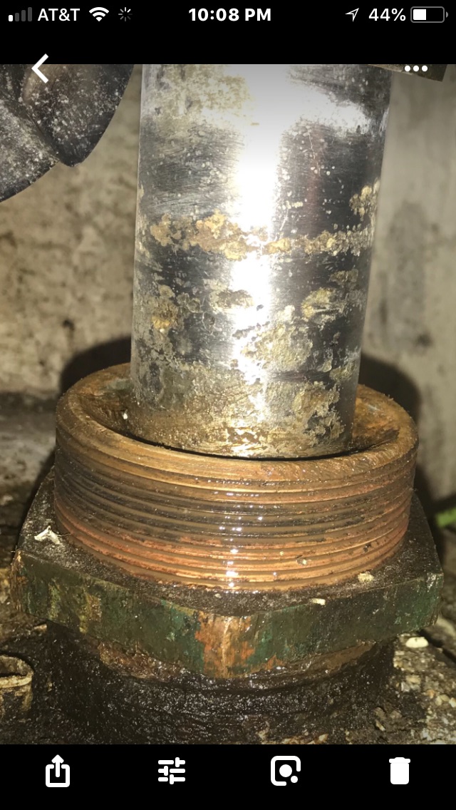

tcollins2
Posts: 172
Location: Huntington, NY
Re: 12 Meter Rudder stuffing box flax size
Post by tcollins2 »
Well your chart is spot on 1-3/4 rudder shaft and the flax to fit was 1/2 inch. Penetrating oil and some leverage and the lock nut can move free now. Wire brushed it and I noticed some pitting. I’m not concerned, but should I be, it’s bonded to everything so how else could it be pitting? The port side shaft is cleaner due to better access and no evidence of putting.
