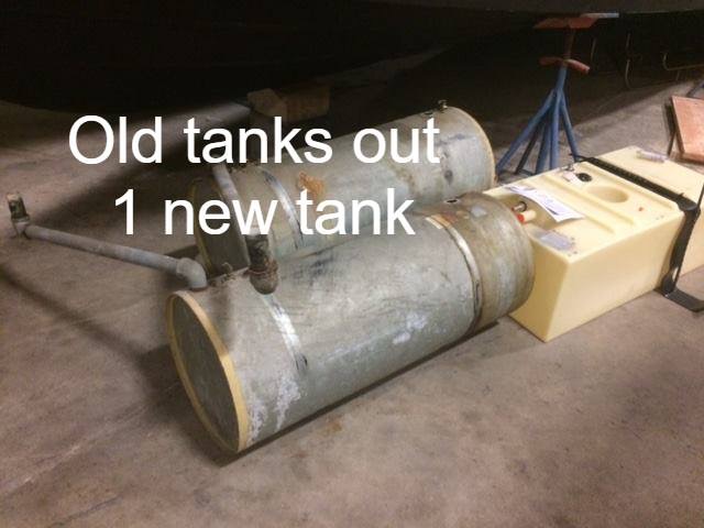

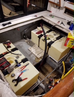

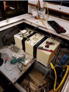

Here are some pictures and information on the installation of two Moeller 58 gal fuel tanks installed in a 1977 F-32 model 321.
Fuel Tanks are made of Polythylene
There tanks replaced the aft original galvanized round tanks.
Tanks are 44” long by 21.50” wide by 18.75” high
We have some good pricing and shipping cost on these tanks
* For a F-36 Moeller makes a 126 gal tank like the picture above.
54" Long by 32" Wide by 21.25"
** High add 2-1/8" to tank height to accommodate fill height

With two very big pipe wrench’s
Note the fuel fill is 1 7/8” and new Plastic tank is 1 1/2” hose.
You need to remove fill and weld a reducer on the fill to bring it down to 1 1/2.
Note: you need to provide a new ground to the fuel fill.

If you have the original deck fills, remove them from the boat, they come apart and you can screw a new correct fitting to it to fit the fill hose......access to the fuel fill hose connections is behind the aft panel in the side sliding storage areas.It is quite easy really, just cut the hose that joins the deck fitting to the pipe , also a ground strap is there.That is how our 78 was, did the same job.
