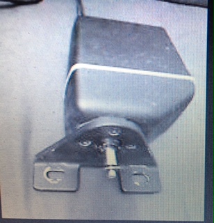

We were ask to find a Autopilot for a owner of a Trojan F-32 model 320 with chain drive steering. After talking to a dozen company’s here is the best option we have found for a chain drive ( non hydraulic Steering)
We found that the best option is RayMarine
Rotary type 1
Part # M81135
EV 200 Core Pack
T70156
RayMarine Contact : Winston Savage
603 324 7600
Winston.savage@raymarine.com

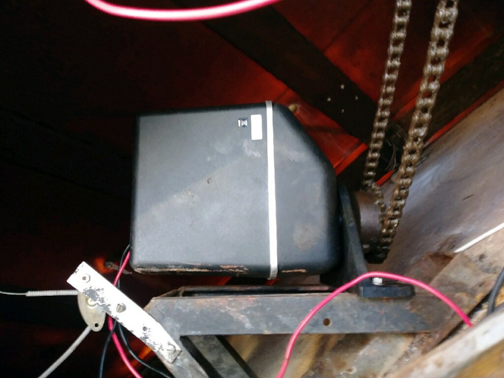

The shaft on drive unit is 5/8 and the key is 3/16

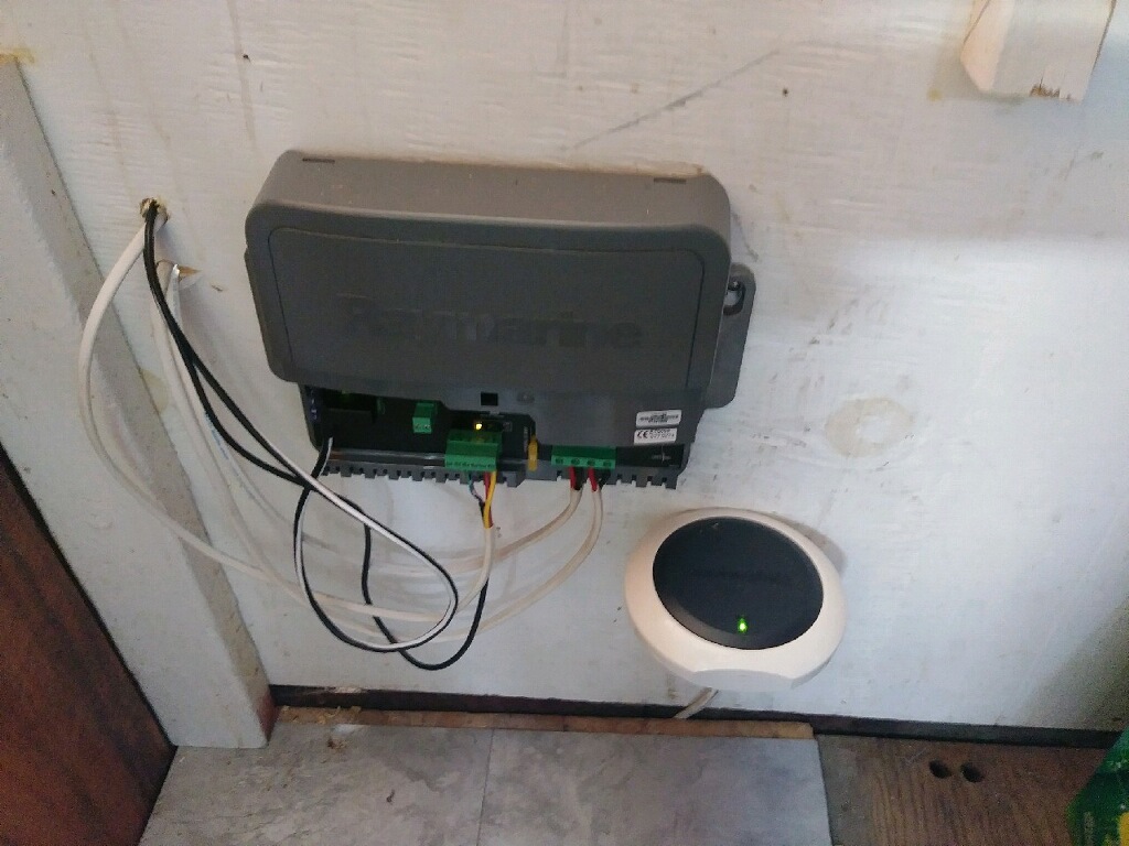

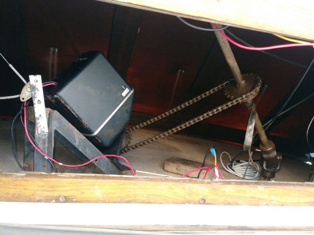

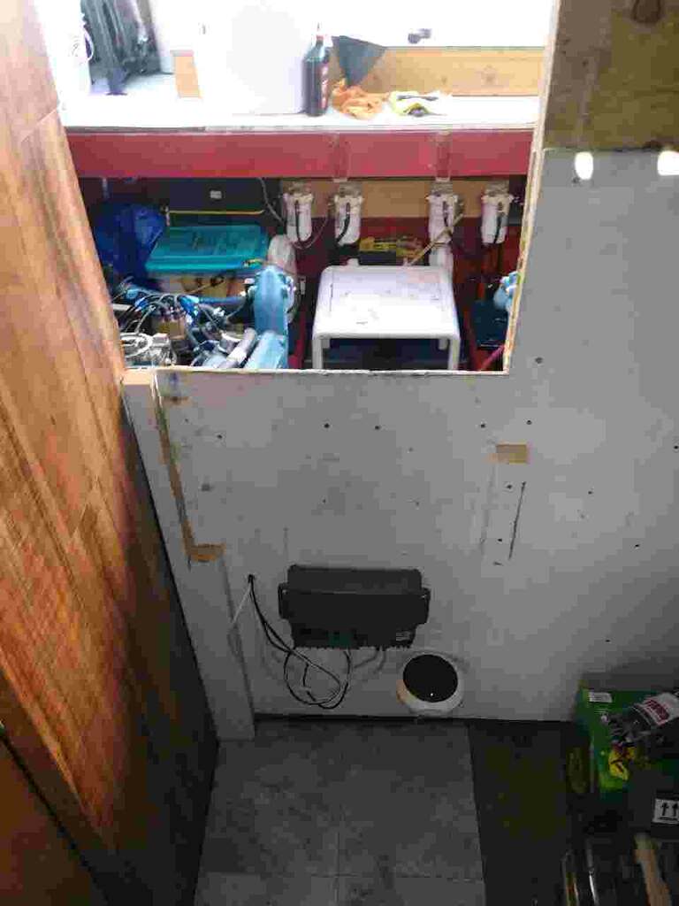

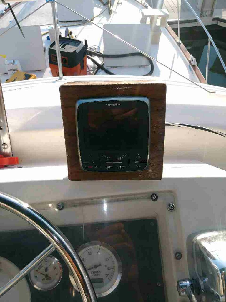

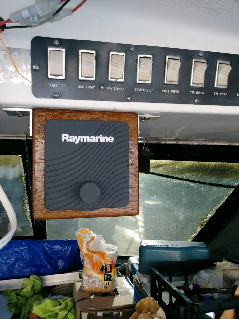

Here are finished photo of the installation
