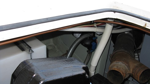

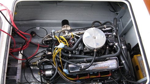

The first 2 picture show some of the original component locations.

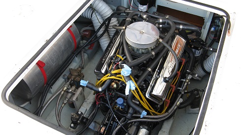

This next picture shows the bilge with the new tank mounting tabs epoxied into place and a fresh coat of paint. O yeah, did I mention that I had to get in there with a reciprocating saw and cut out the old tank mounts.

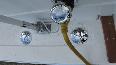

While I was at it, I figured that it would be easier to fill the water tank from a standing position on the dock as opposed to being on all fours on the floor of the cockpit filling it thru a deck plate on the floor. So I installed a deck plate and hose to accomplish this however it made my old gas deck plate look like sh*t so I replaced it as well. And speaking of sh*t, I didn't want the waste deck plate on the other side of the boat to be the only oddball so I replaced it as well.

Below is a picture of the new deck plates installed, don't mind the end of season dirty boat. The spider seems to approve.

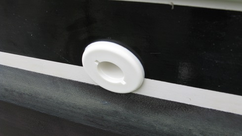

The last picture is one of the new bulkhead fittings for the hatch drain.
