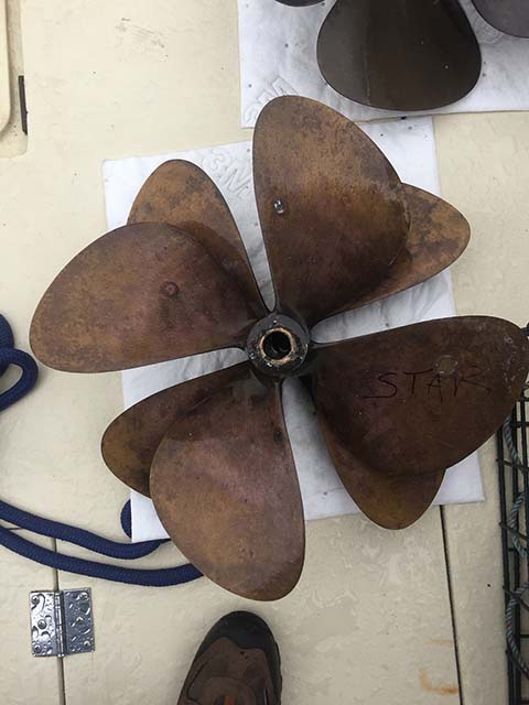

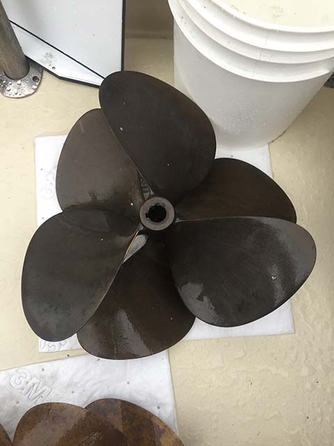

Hey Prowlersfish!
The props that were on the boat were 4 blade 20 x 19's. The props I found are 3 blade 20x20's. The 4 blades are discolored, the mechanic said it was from current leakage in the marina. The props did not look pinkish when I bought the boat... I had a marine do a test for current leakage on the boat and he did not find any. I do see an isolation transformer in my future. The mechanic and others have told me that the discolored props are brittle and could crack and break apart. I appreciate your input I feel better putting on the three blades. And I do understand your comment that every boat is different. Once again, thanks prowlerfish!
P.S. Not looking for props anymore, thank you guys.
