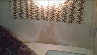

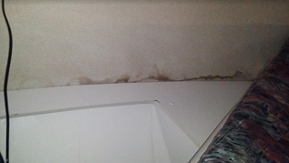

**The one thing I saw on the boat was water intrusion around the windows in the V-berth. There was a decent amount of it.

I've attached photos of the water damage and the over-all boat

I have owned our Trojan 350 for over ten years. Great boat. I am very tall (6'7") and this boat has the head room I need. Very fun to drive, gets on plane and cruises at 3200rpm @ 23-25mph. The Crusader engines are great. When I bought the boat, first thing I did was removed all the port holes (windows) and re-bedded them. I have the same color for the cabin, purple or mauve or what ever it is. I hate the color, and have plans to re-upholster it to tan. Also, the boat has wide side deck to get to bow. no crawl thru windshield. It has a solid fiberglass hull and feels solid when underway. The only thing I dislike is where the batteries are in the engine room. center line under deck plate. very hard to inspect. The generator is kind of hard to check oil. The head has the nice touch of a glass shower door in the wet head. Works very nice. Aft cabin is good for the kid or overnight couple. If I was to list ours today, it would be no where near the 43k. I would start at around 55k. So you might have a fair deal.

Your hull is solid from the rub rail down. I had a survey performed on mine whereby we drilled holes to confirm the hull was solid fibreglass, then used the West System to fill in drill holes. Above rub rail the hull is cored.
I believe port hole style window seals can dry out in most boats, however my experience has been that in the case of this model they don't see much water from wave action nor rain. So I'm not sure why the seepage unless the boat was out in some sizeable wave action. But I see that your plan is for a thorough survey anyway.
