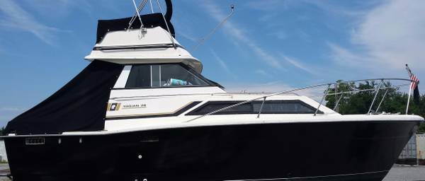

$4200
black hull.jpg (16.26 KiB) Viewed 12714 times
