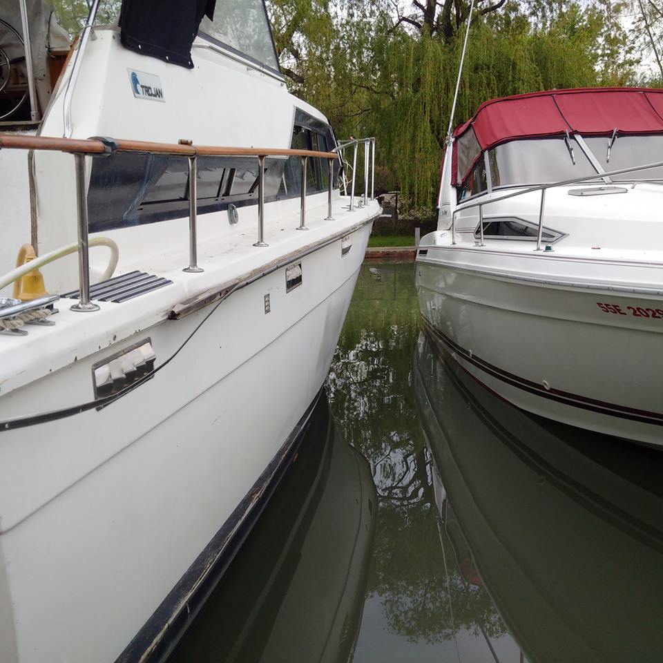

No big deal... just float it out. Hand over hand, walk it forward and just have crew hold you off the Sea Ray. Getting back in will be the fun part!
Plan B (from what I am seeing in the pictures....) the Sea Ray bow is not as far in to the slip as your stern is... pull it forward and re-tie and that may give you more room to get out and back in... Looks like you are all the way in to your slip, but they are 10' off the main pier.

As for the the pic I submitted, yes captainmaniac I figure my only way out is to float it out. Myself and the SeaRay are tight to our respective sides, and both all the way in. The problem is the finger dock are angled and not parallel to each other. I mention my concern about getting in and out to the marina owner and his response was " How much room do you want " lol . But yes getting back in will be the fun part. I changed marinas this season to explore different area, so I guess this is the price I pay
