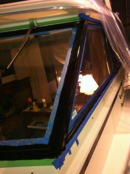

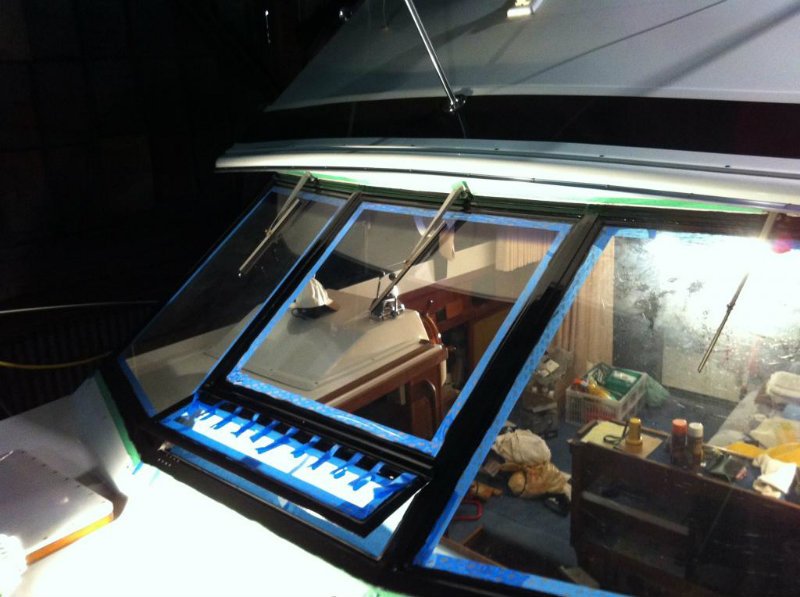

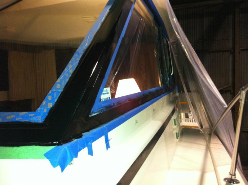

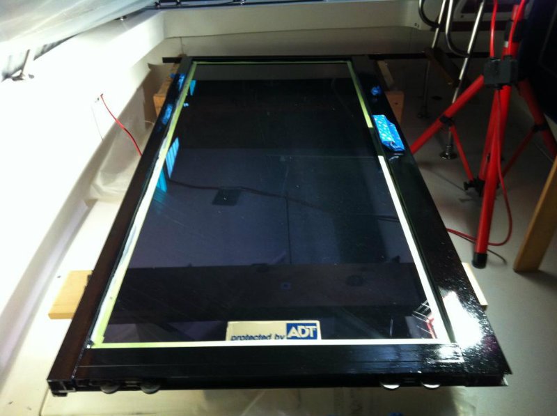

Never had problems with corrosion. I am in fresh water - I am guessing you are in salt? Different situation. I did clean up / sand a few spots down to bare metal / reprime / paint my frames a couple of years back to freshen them up and deal with some paint that had chipped/flaked off (and aluminum was exposed). The main thing was to get primer on very quickly after sanding / exposing the aluminum to stop oxidization from starting, than get paint on fairly quickly before primer and other surfaces got contaminated with 'stuff'. I only dealt with exterior face surfaces (didn't have to deal with anything inside of the tracks). Paint I used was Interlux Brightside (Black). Did 2 coats in the end. Probably not much use, but here are a few pics of work in progress.
