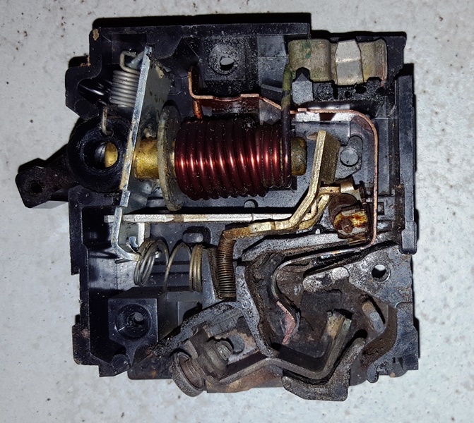

We also have one of these small heaters that does a good job taking the chill off, but is not adequate to really heat the boat on a very cold day. It is a help in the spring when the water is too cold to run the reverse cycle heat. Looks like they are currently on clearance. https://www.westmarine.com/buy/west-mar ... ecordNum=2
They do draw 12.5A at full tilt and that should be worthy of some thought if your wiring is old. One of our circuit breakers failed the first time we used this heater, luckily in a no connection mode. I did some research and it appears that this breaker had problems and was recalled many years ago, so I can't really blame the wiring. It was a 15A breaker and probably tried to trip and started arcing until it failed. You can see the burned contact in the lower right of the photo.
