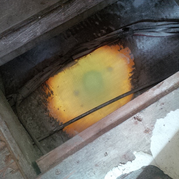

Sorry I have not updated in some time. I was busy with other priorities... Anyhow, through hulls are all replaced and extra holes glassed. Boy did I have fun! The first hole I glassed was almost a month ago but I got in trouble big time. Weather was hot, and it looked like thunder storms in the horizon. So! I prep the hole, clean everything with acetone, cut my patches for both inside and outside, I prepare my fancy weaving under pressure! clouds are now really dark and wind is blowing. A drop here and a drop there no big deal right? Wrong! Big big deal! it start to pour and pour a lot! thingy get my vacuum bag system ready to go and I take the jump. I mix a batch of epoxy with the slow 206 hardener. I place my weave and start applying the patches. Half way, epoxy starts to set... I mix a second batch and push on. I complete the inside, go outside and continue
At this point, I need to tell you that I only have an extension cord to run the fridge. No shore power or batteries are connected.
So! As I was saying, It is raining hard. Real hard... Water in coming in the boat from everywhere. Lots of it. Water level in the bilge goes up and up and finally, you guessed it, covers my freshly glassed hole.
At this point I say out loud F&^%$ it close shop and go home...
2 weeks later, I am back, remove the glass and start over. this time I get smart! I check the weather, It nice and cool, no storms on the horizon and I pre-saturate the patches before applying to the boat. This time I got plenty of time to do everything no problem. I unfortunately did not have time to take pictures nor did I use my fancy vacuum bagging system... I did complete all 3 holes. 8)
Here is a picture of the aft head condemned through hull hole...

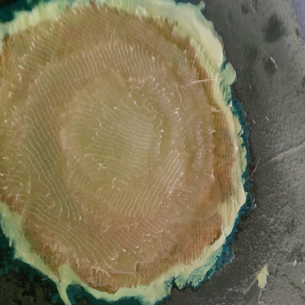

Now for the outside.
All I need to do now is clean it a bit and fill to make it nice and flush with the hull.

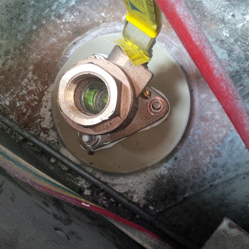

the next day I tackle the 9 seacocks. I came up with a pretty efficient method to do this alone. I chamfered all the bolt holes on the seacocks from the underside (side that will sit on the hull) to help make a seal. I measured and dry fit all the through hulls. Then, I put the sealer on the base of the seacocks, slide in the 3 bolts in the flange and drop the seacock in place. I go outside, install the through hull just snug. I push in fresh bolts from the outside making sure there is sealer on them (this pushes out the bolts previously inserted from inside) and tighten the through hull properly. I then go back inside and torque the nuts with a torque wrench. Tightening the through hull before, made the flange of the seacock turn just a bit and pinch the bolts preventing them from turning while torqueing. That's it. Pretty simple! I was able to do 2 seacocks at a time using this method.
I am really happy with the results. looks clean and professional. IMHO...
