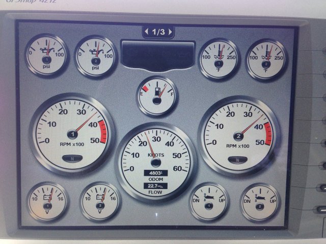

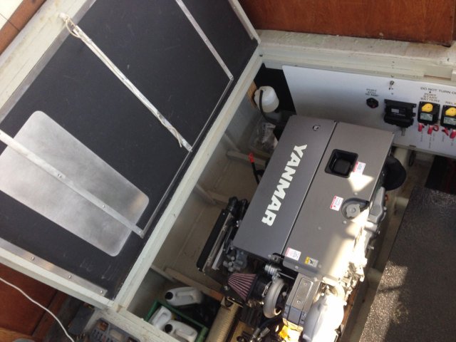

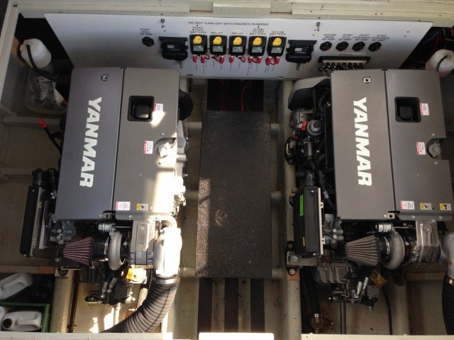

Pretty much done. Just a few loose ends like carpet and installing the upper helm instruments.
Sea trials went perfectly. Not single glitch. Prop size (17 x 16) is perfect, allowing engines to reach mandated RPM (4100) exactly. Recommended cruise RPM 3600 results in 24 knots speed (see image), exactly where she cruises best. I'm a happy guy.

Sweet ! Do you know what your load is @ wot and 3600 ? ( not sure iF Yanmar shows that on the display ) It looks great Very clean install .

Lots of other data like percent throttle, turbo boosts, various temps, but I haven't seen load. I'll look.prowlersfish wrote:Sweet ! Do you know what your load is @ wot and 3600 ? ( not sure iF Yanmar shows that on the display ) It looks great Very clean install .

Ran the boat again yesterday. It does read the load, but I did not note the reading at 3600 RPM. I'll try to remember to take that reading today.prowlersfish wrote:Sweet ! Do you know what your load is @ wot and 3600 ? ( not sure iF Yanmar shows that on the display ) It looks great Very clean install .

Load is 85% at 3600 RPM. Is that good or bad or about right? I have no idea.

The Yanmar 6BY3-260 (BMW marinized by Yanmar) is the PERFECT replacement for a 350 Chevy. Almost identical footprint, 260 hp, 3600 RPM cruise (4000 WOT), and 350 pounds lighter. Most of the other specs and data are in this topic stream.lumbo wrote:Great project! I am about to start to repower a 77' F-321. She presently has twin 350 Gas Crusaders. I want to repower to Yanmar diesels. Where did you start to find what Yanmar engines best fit your boat model? Thanks. I look forward to your feedback.

Is it any taller than the 350?DAVIDLOFLAND wrote:The Yanmar 6BY3-260 (BMW marinized by Yanmar) is the PERFECT replacement for a 350 Chevy. Almost identical footprint, 260 hp, 3600 RPM cruise (4000 WOT), and 350 pounds lighter. Most of the other specs and data are in this topic stream.lumbo wrote:Great project! I am about to start to repower a 77' F-321. She presently has twin 350 Gas Crusaders. I want to repower to Yanmar diesels. Where did you start to find what Yanmar engines best fit your boat model? Thanks. I look forward to your feedback.

That info has been hard to find from Yanmar . I had in mind 80% as the happy number . But remember my mind is Cummins based . I did find some generic Yanmar info saying cruse rpm should be 85% of rated rpm that would put you at 3400 rpm , BUT this was very generic and maybe pre Common rail /BMW base .
Remember factory rating info tends to be near the max limits . Mine for example tells you can run 1 or 2 hour at WOT or every 8 hours . I would never ever do that . It mabe in the rated use (max) but if you want max life out of the engine running easier is the key .
Was the 3600 rpm cruse in the Yanmar info you have ? I am trying to do more research on Yanmar loading .
I do have a few more questions for you on your numbers ( load/gph/MPG ) at 4000 and 3400 and at 7-8 knots ( what ever rpm that is )
Your sure have done a great job . this engine/boat combo seems like a perfect match

Data that comes with the engines says 3600 is optimum cruise RPM.
3600 yields 24 - 24.5 knots and 1.2 NMPG.
Both engines running at 1200 yields about 6.8 knots and 3.5 NMPG.
Those economy numbers are double what my tired old carbureted 350's gave me.
I haven't yet tried single engine running hull speed, but that was where my best long range economy was found with the 350 Chevy's. I'm hoping for over 4 NMPG.
