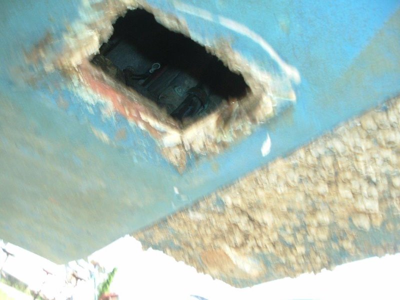

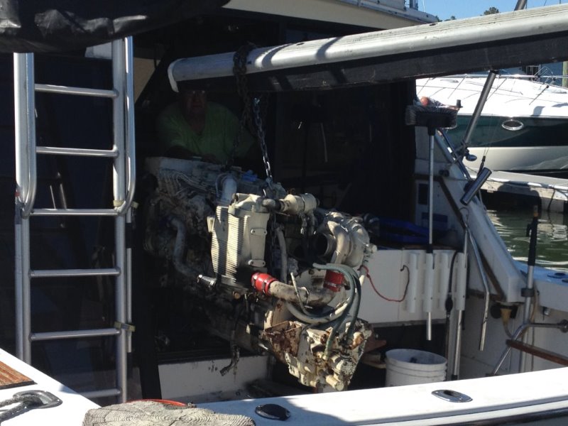

Using Sea cast to repair a string is a patch at best. The even tell you its not made to be used this way , and not made to stick to wood . And Again no one here is paying tens of thousands for things above the skill set . They are doing it them selves . Unless your skill set is pooping parts its costs
Care to guess the parts costs on these do it yourself projects ? All done with my inferior skill set :shock:
hull failure.jpg (70.46 KiB) Viewed 11433 times
engine removal.jpg (82.29 KiB) Viewed 11433 times
