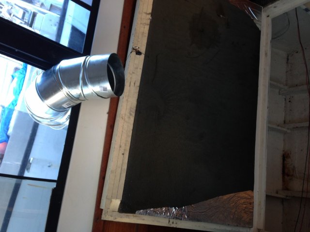

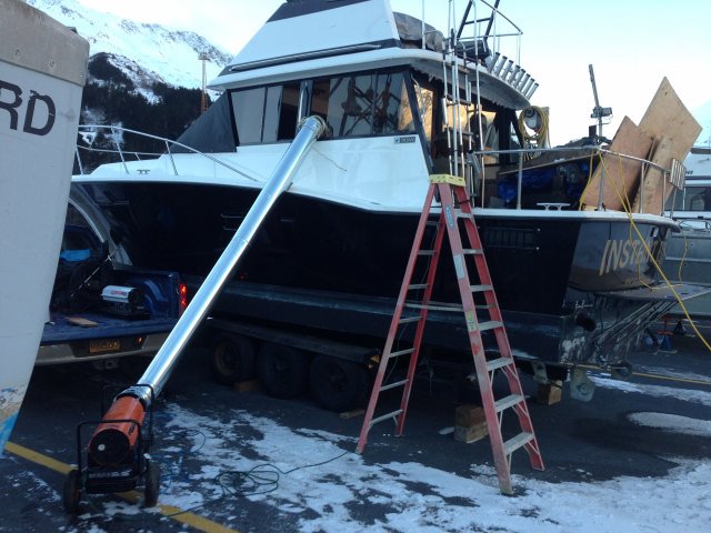

I am curious how you manage to "spot heat" areas that you are working. I need to do some glass work in the transom area and I need an ambient temperature above 60* using 105/205. I was going to get some heat lamps, or use some halogen work lams focused on the work area, but I worry about leaving it unattended over night.DAVIDLOFLAND wrote:Problematic as the temperature and weather is, it's still doable by heating just the areas where I'm working.

Heating up an area of the boat with ducted space heater

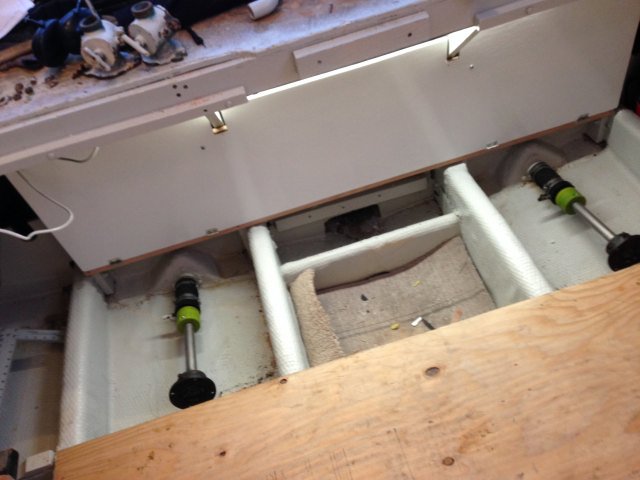

Days 8 and 9, sound deadening installation. Mass Loaded Vynil Barrier. Not much to share image-wise, except the one I added of my wife spending day about 3 or 4 with me in the bilge. I have had some very good luck. One, buying an F32 25 years ago when I was 30 years old. Two, marrying this girl six years ago. She works six days a week and then spent her day off hanging out with me in the bilge.

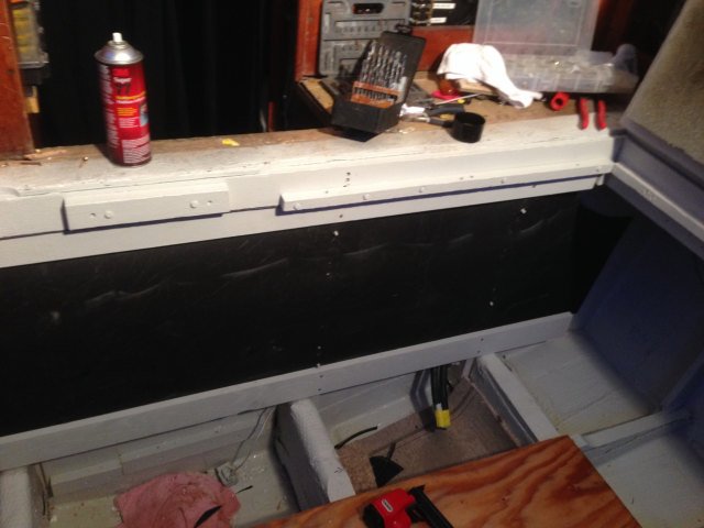

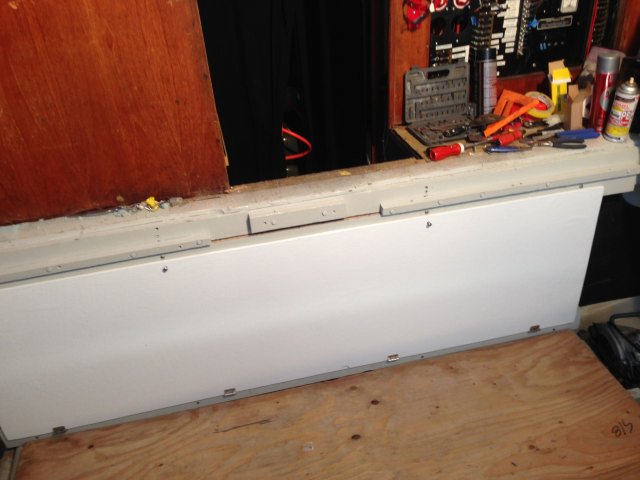

Day 8 - Installed the panels to the forward and aft bulkheads in the engine room. Panels will accommodate electrical and fuel supply components to the engines. Panels are hinged at the bottom for easy access to the backside.

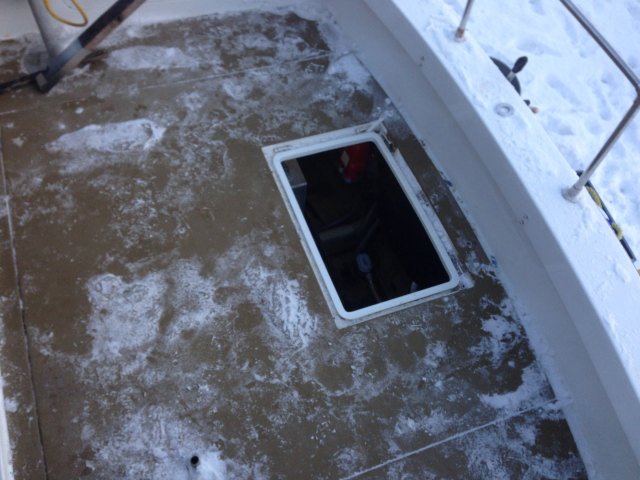

Day 9 - Removed ladder to flying bridge, unfastened cockpit deck, and attempted to remove deck. Deck is frozen in place (how'd that happen in Alaska in Winter?). Broke an 8' 2x4 trying to pry it up. Said effit, and came back to town to watch the Super Bowl. Will thaw and remove the cockpit deck next weekend.

- COCKPIT DECK FROZEN IN PLACE

- AFT BULKHEAD FUEL PANEL

- FORWARD BULKHEAD ELECTRICAL PANEL

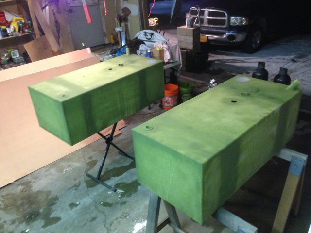

Weather is slowing me down too. I have the fuel tanks and exhaust ready to go back in, but did'nt quite get them in yesterday.
The MLVB I used is just the 1/8" vynil only (sold in a 54" x 60' roll), so not much heat insulation, if any. You would need to use the product that includes the foam and foil to get heat insualtion as well.
