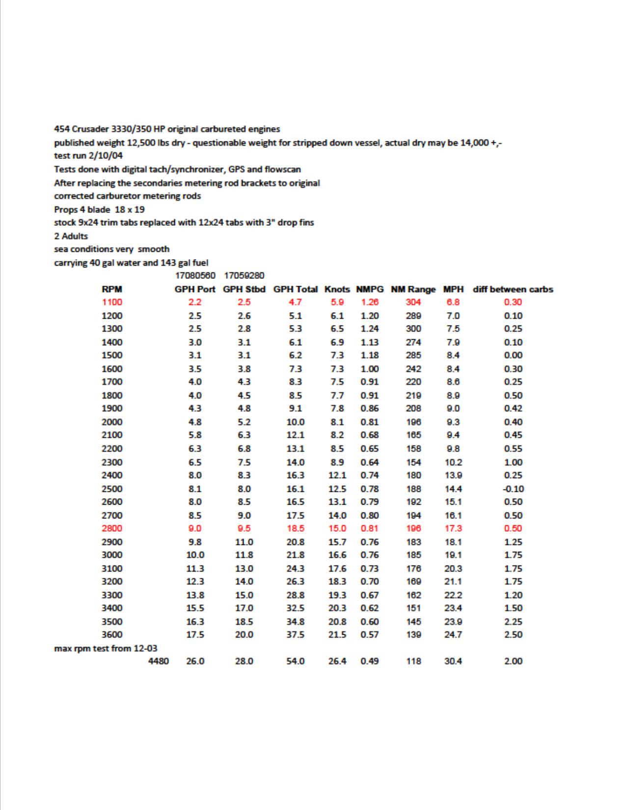

My earlier post now has actual data inserted for a 1983 10 Meter International
454 engines and 4 blade props
The data was collected with Floscan, GPS and a digital tach/sync.

Todd,
Your numbers indicate a far higher burn rate than those I have provided.
Different hulls, gears, props yes, however at displacement speeds, the burn rate should be reasonably close as the engines are identical.
Tony Athens over at BoatDiesel maintains that it is the PROP that moves the boat, not the motor.
I wonder, if you installed a floscan you might be surprised that your actual hull speed fuel burn may be more similar to mine.
Plus it would be interesting to see the actual hull speed data with one engine only vs. two.
My planning sweet spot shows up on a 2004 test after doing all the modifications.
I will convert that spreadsheet and post it here shortly.
At 2800 RPM I was running 17.3 kts, getting .81 NMPG - not bad for a gas burning vessel of our size .
- THS IS THE FINAL DATA AFTER DOING ALL THE MODS
- RWS_GAS_ACTUAL_DATAONLY_DETAIL.jpg (152.27 KiB) Viewed 10384 times
