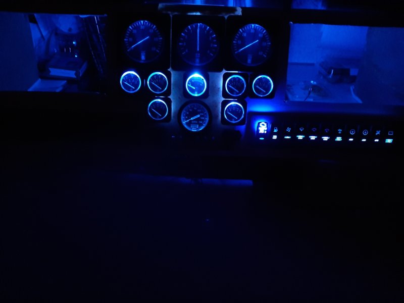

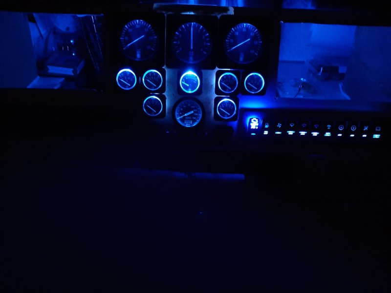

Making progress on wiring. Here is a test of gauges and 1 of the switch panels.

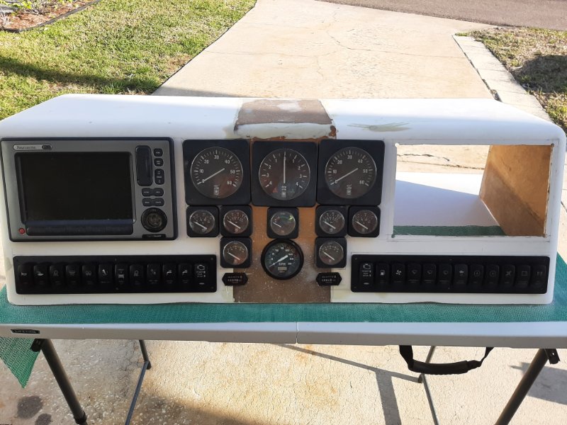

Finally got the dash free. After many methods did not work. an additional 2 hours of prying got it off. You can see I also removed the hard to find Morse SF controls that I will offer here before listing online.
Test fit the dash again after clearanced out for the door as you can see in the pics before I removed the controls.

Today, I removed the SF controls and widened holes for the top mount Morse.
