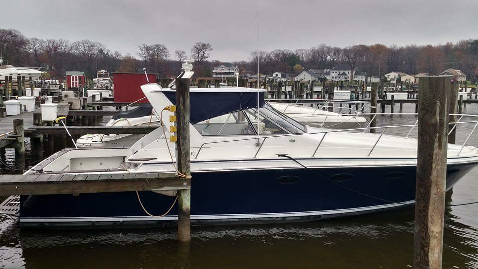

Hello all,
I am in the process of buying an 82 Trojan 10 meter express. It has had some work done and is a pretty fair price I think. I have a couple of questions hopefully someone can help with? I put a deposit on the boat and will pick it up this weekend.
1. Under the front birth, there is a storage locker. I noticed that the floor to this locker is a piece of plywood that is rotting. The owner says his surveyer told him that it is non structural and not to worry about it. fix it if you want. Anybody have any experience with this? I know I will need to make sure wherever the water is coming from needs to be fixed, I am more concerned about if this is anything to worry about?
2. I am under the impression that these boat are mostly fiberglass under the water line including the stringers from posts online. Is this correct? Well with the exception of at least the bulk head behind the engines. This bulkhead does have standing water against it and does not look rotten but im sure its got some moisture in it. I plan to be more vigilant that the current owner at keeping water out of the bilge. He likes to kill power to the bilges due to oil leak and not wanting it to contaminate the "clean marina". Should I be very concerned about this bulk head? The floor seems pretty solid.
Thanks for any input! If you think of anything else major I should be looking at please let me know!
