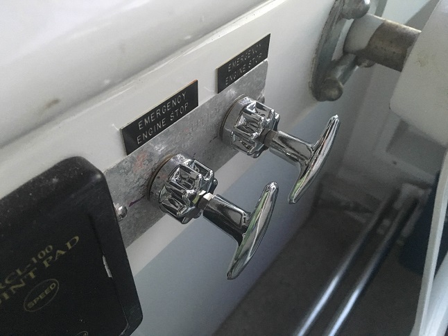

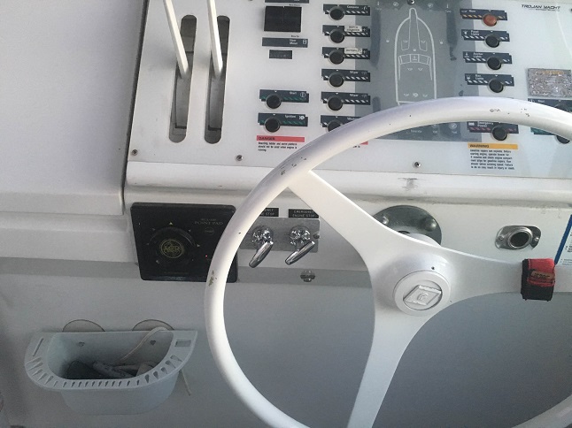

Beacon sent me all the parts probably two months ago and since tropical storm Hermine kept every one in marinas, so I decided to install them this weekend. The boat was conversion from gas to diesel so there was an aluminum gas fume safety plaque on the dash where one of the switches was supposed to go. I put both switches next to each other since the previous owner put a 12-volt cigarette lighter where the starboard pull knob was to go. Not a bad install, 3 hours, but the key was to remove the microwave from inside to snake the cables.
Post install I wanted to try them out since they were working as designed with the motors off. I could see the air damper levers pop and I could easily reset them. Idling at 600 at the dock, I pulled the knobs to see if they would actually stop the motors, the motors never actually shut off, I'm sure the air damper caused the air starvation and why the engine was struggling to keep going for about 25 seconds. I intervened and turned off the motors by shutting off fuel flow the normal way.
Does anyone have any experience with actually using these? I'm glad they are installed now but I was expecting the motors to actually stop. I can assume one would use these during a run away situation and cutting off about 90% of the air would go a long way to reducing the RPM.

Make sure they are getting full travel and nothing is bent . Any air leaks between the shut off and the block can cause a issue Engine could even suck air from the crank case with weak lower rings I would thing . Remember these are EMERGENCY shut offs and should be only used in a emergency ( like a run away ) its not good on the engine . learn to shut down your engine by pulling the stop solenoid on the engine in case you have a electrical issue .
Re: 12 Meter International - Diesel Emergency Shut Off
Pics
- Shutoff1.jpg (88.85 KiB) Viewed 7925 times
- Shutoff2.jpg (88 KiB) Viewed 7925 times
Nice clean install!
Where are your shut off buttons for the engines?
In the top photo you can see the port shut off button underneath the starboard emergency shut off knob.
