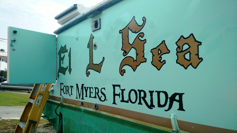

Just wanted to share another update. She finally has her name on! My father in law works in graphic design and had this made based on my rough sketch. Pretty excited about how it turned out.
We went with navy lettering because when I re do the canvas, I think I'll be using navy...

looks Great!

Awesome. We just did ours when we had the bottom painted.
