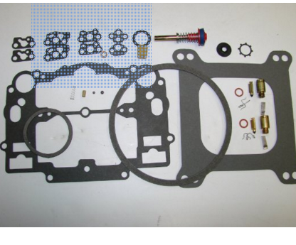

This is the kit I ordered. Hope it works
wolfe99
Posts: 10
Joined: Sun Jun 19, 2016 12:11 pm
Re: Carter rebuild kit help ???
Post by wolfe99 »
Said it worked with Carter ABF

You need to get the number stamped in the carb to be sure right kit. But in all likelihood that one will work fine. Make sure you get it clean. I soda blast mine after soaking in carb cleaner. Then wash with water and blow out with compressed air. I keep two spares that are rebuilt and ready to go.
