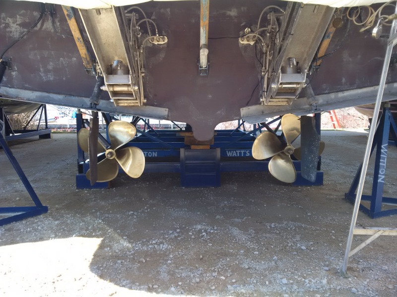

Hi again landloctbtr
Just a clarification...... my props just arrived and they are....
Michigan Wheel DynaQuad 24" x 24" 4 blade bronze
to match what was there.
Ron
Ron
Re: Prop Replacement
Good to go. Very pretty.
Interesting.... the smaller nut is the prop nut, the larger nut is the jamb nut and goes on last.
RonW
RonW
- IMG_20160417_150313.jpg (154.99 KiB) Viewed 7156 times

New props look mintRonW wrote:Good to go. Very pretty.
RonW
