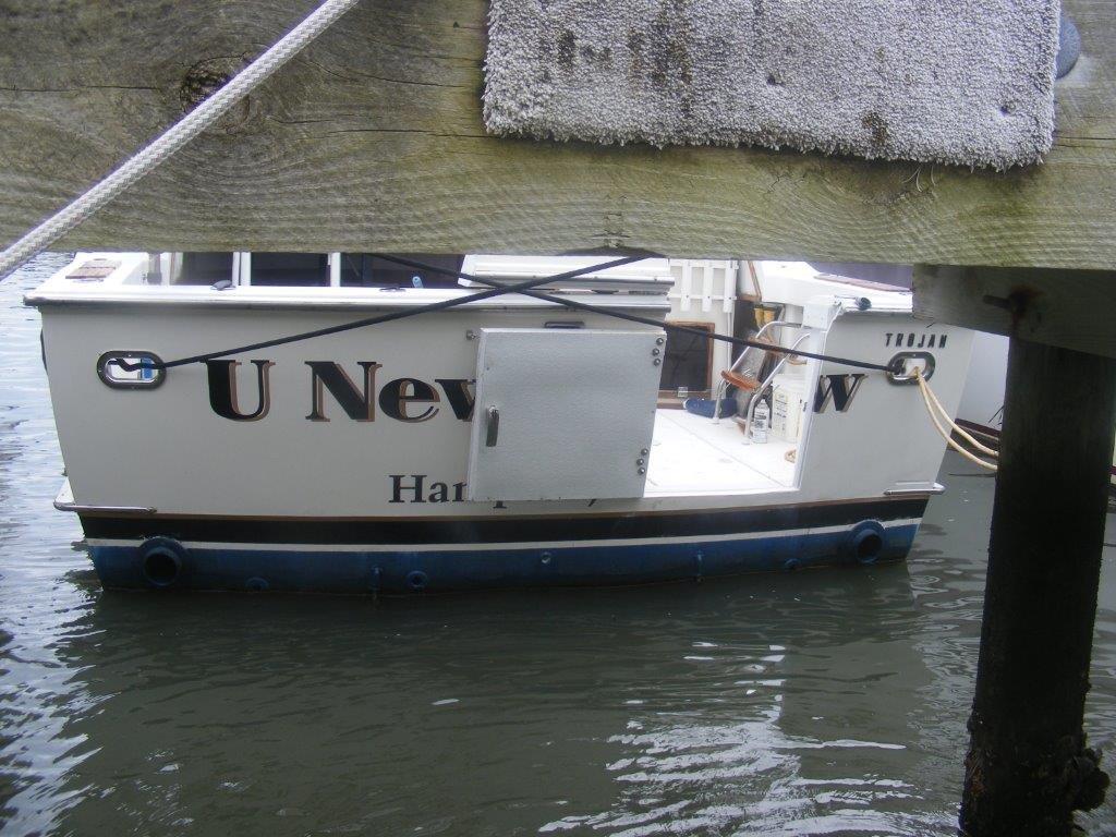

If having the power cords over the transom is what you want to do away with , conceder hawse pipes . I did this on mine manly for the dock line but I also run the power / water thu them . and down the side of the cockpit out of the way .( I will post a pic )

Hawse Pipes
- T door done.jpg (132.91 KiB) Viewed 8809 times

I also like the hawse pipe idea/look, but it wouldn't work on an F32. The pipe would lead straight to a semi-enclosed area and into the bilge. No scuppers to evacuate.

Hawse pipe should work fine on a F32 . I had to cut through the transom and the inner" liner" they are about 1-2" apart . I belive the F32 is the same from what I remember .Scorpion07 wrote:Thanks prolersfish.

Its just something that I did to the boat and really liked it . Main reason was to lower the dock lines when at a floating dock . So it was easier to step out the transom door . But I like not having line and power cords going over the transom , Just a bonus .
