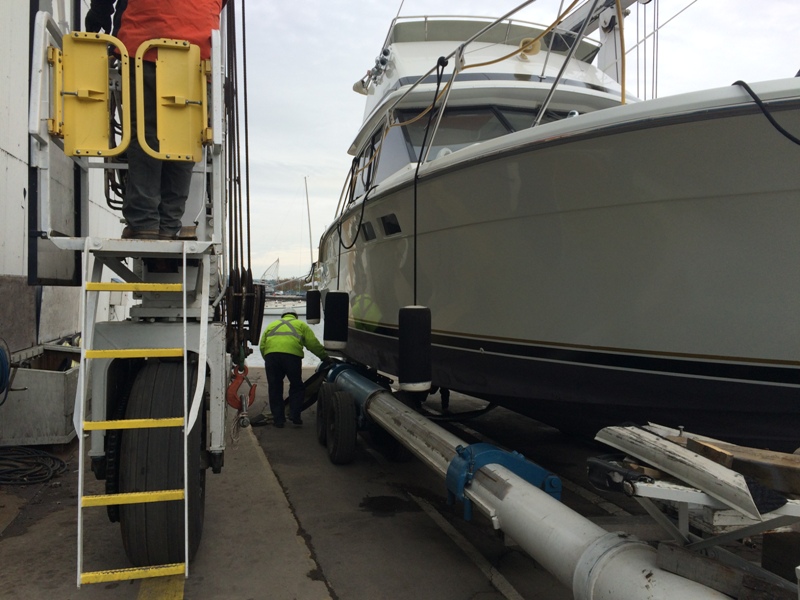

Boat looks great. I am sure it was nice to finally enjoy it. Transmission OK?
Re: 1987 10 meter mid cabin complete restoration.
Thanks! I was nice to see her floating again. Still not sure exactly what wrong ,if anything, with the tranny. Will be checking that I have spark at all 8 cylinders and confirm that the plug wires are run correctly. I also need to raise the engine idle up a bit and hopefully that will help.

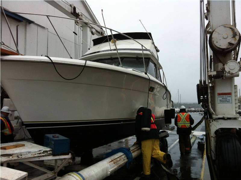

Don't want to sound like a --bleep--, but have never resorted to a buffer. That's a lie -- I picked up a random orbital buffer from Canadian Tire in the mid 90's for my previous boat, and used it for 2-3 years on the Trojan. On the prior boat (1987 Four Winns Liberator 261) found I was cutting through the gel and exposing raw fiberglass on the deck. On the F32 hull, found it just left swirls and other crap I didn't like due to inconsistent application of polish / changing temperatures / etc, and couldn't get a consistent result from it. Have been manually polishing and waxing hull sides and superstructure ever since (maybe 2003 and beyond). I stick with Meguiars' products - 2 hours a side for polish and wax each, for some reason transom takes 2 hours plus even though it is much smaller, and potentially adding StarBrite Premium Polish with PTEF (Teflon).
The gel on this vintage of Trojan is AWESOME, and INCREDIBLE - I can do a manual polish and wax in the spring, and have such incredible reflection that yard workers just POP in launch photos. I have seen pictures from BJ and others that testify to how incredible this gel is.
What I have is 35 years old, but don't doubt that some day I will need to get more aggressive with the gel, so hoping that the latest subject of this thread tells me what the most beneficial, but least damaging, buffer and polish combination will be.
