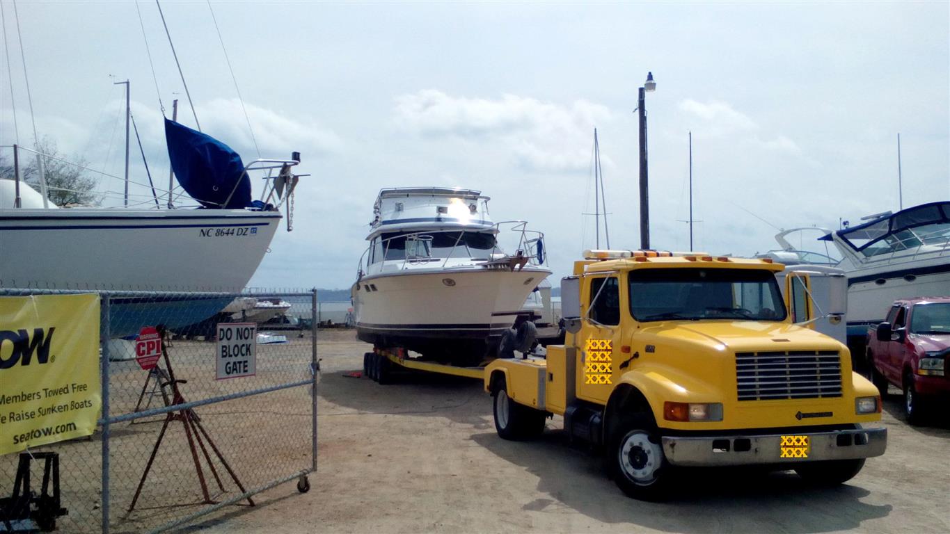

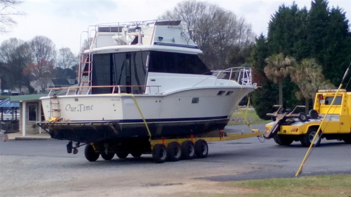

I just had my F-32 shipped from Lake Norman, NC to Myrtle Beach, SC on a lowboy trailer without removing the flybridge. Oversized permits
were needed ($125.00) & the department of transportation (DOT) told of which route had to be taken. I received quotes ranging from $3,200 -
$3,700 for removing the bridge for transporting to $1,525 with the bridge intact for a 197 mi. trip.
