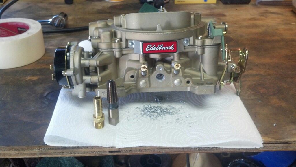

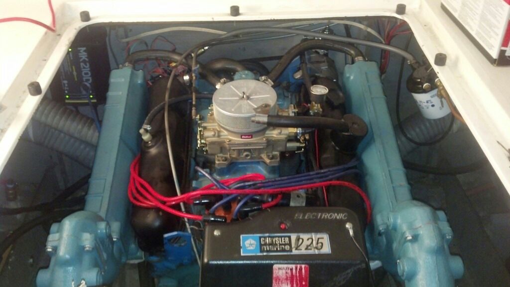

New 1409, The carter 6212 went through its last rebuild. Install pretty straight forward, after a few adj, idles perfect, responds great, very excited to see how it runs in the water. About 3 more weeks!

Looking good. Won't be long now.

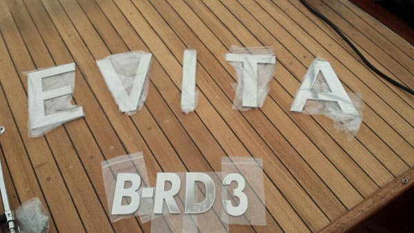

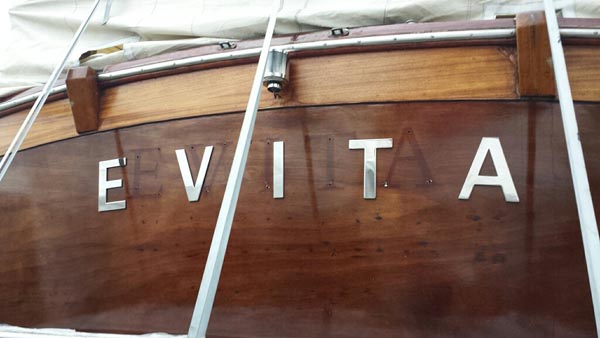

Will repaint the stern and install new letters in stainless steel.
Have to close all holes with mahogani plugs - first try where to install.

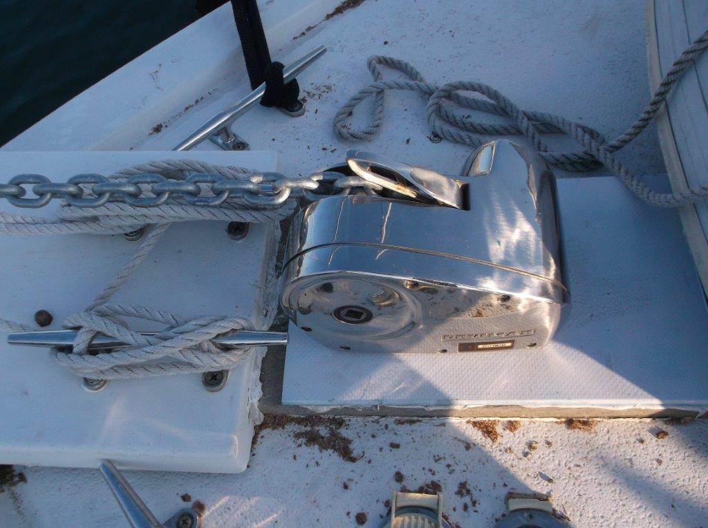

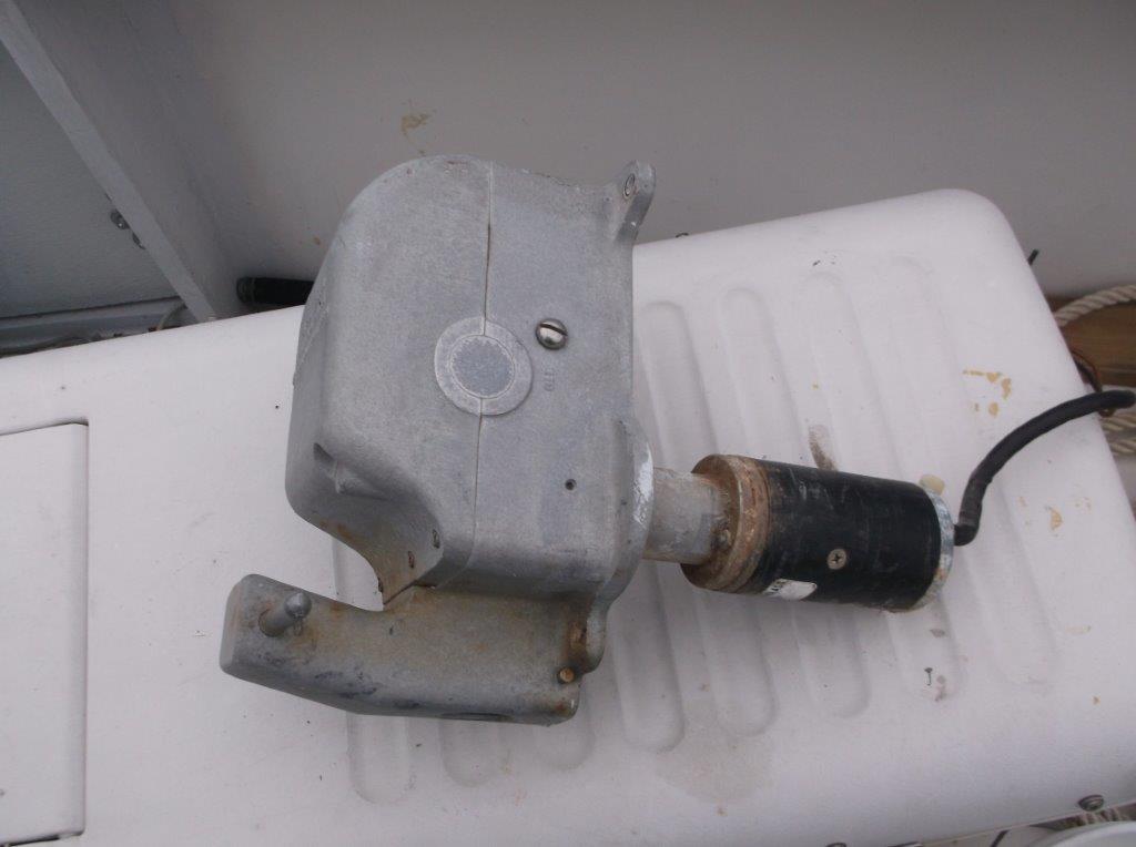

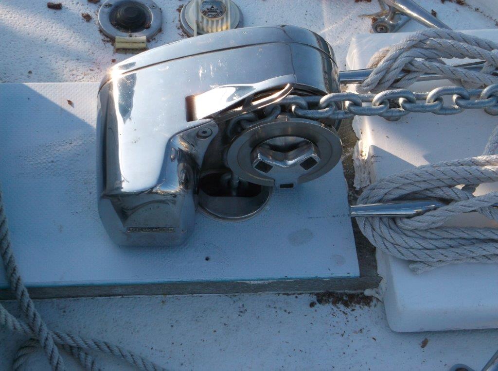

Out with old in with new .Replaced the windlass to day with one that can use rode and chain
Old good windlass
Old good windlass

new
new
new windlass.jpg 1.jpg (106.89 KiB) Viewed 8291 times
New
New
new windlass.jpg (106.06 KiB) Viewed 8291 times
Re: Up Grades
That's sweet Paul. I like those units. Do yourself a favour, if you weren't getting much water in your bilge before, make a cover for the unit so you don't get rain water going into the chain port. Also helps when under way in poor conditions with water breaking over the bow. Seems to be the number one complaint so I warn people now before they go with a deck mounted unit. Of course if the chain locker is isolated from the bilge and drains overboard then no worries.
Re: Up Grades
Too bad about the "Good" windlass. I would have bought one of those when I was shopping because I really really really liked the integrated mooring bit. However, those are rope only, and I consider at least a boat-length of chain mandatory on any rode.
Attn: Good customer service -- do you read boating forums???? Would it have killed you to make a rope-chain windlass with an integrated mooring bit? Vetus got a couple of hundred of my dollars that you could have had....
Re: Up Grades
Big D wrote:That's sweet Paul. I like those units. Do yourself a favour, if you weren't getting much water in your bilge before, make a cover for the unit so you don't get rain water going into the chain port. Also helps when under way in poor conditions with water breaking over the bow. Seems to be the number one complaint so I warn people now before they go with a deck mounted unit. Of course if the chain locker is isolated from the bilge and drains overboard then no worries.
Not worried about a little water in the bilge . The anchor locker drains there but so do the hatch drains on the rear deck , water is the norm . But I do plan on making a cover for it as it is good size hole for the chain and rode .
I may add The windlass is about 1" above deck level , the should help some with water intrusion .

That 38 Y/O Windlass Still worked great and honestly I Never had a issue of not holding with out chain even with 2 other boats tied to me . I would sometimes add some chain If I felt the need . I decided it would be nice to have a windless that handled boat rode and chain . Good was my first choice as I believe they make a great windlass and make it right here in the USA . But are costly .
I went with the Lewmar as it will do the job the price was right and it looks great . The mooring bit is nice but no big deal as I have 4 cleats near the windlass ( 2 in front of the windlass) .
