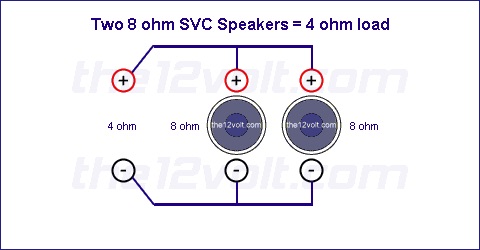

There is a way to use 8ohm speakers to be 4ohm. If you are going to use multiple speakers (qty 4) it would be feasible. Hope this helps. - Lou
Installed link below.
http://www.the12volt.com/12voltimages/2 ... c_4ohm.gif

Lou wrote:There is a way to use 8ohm speakers to be 4ohm. If you are going to use multiple speakers (qty 4) it would be feasible. Hope this helps. - Lou
I had considered this... Have a pair in the Salon, and then a pair down in the berth, but then I got to thinking about balancing and zone control. I think I determined that if I were in the berth for any reason it would be to sleep... And I wouldn't want to listen to radio anyway.
