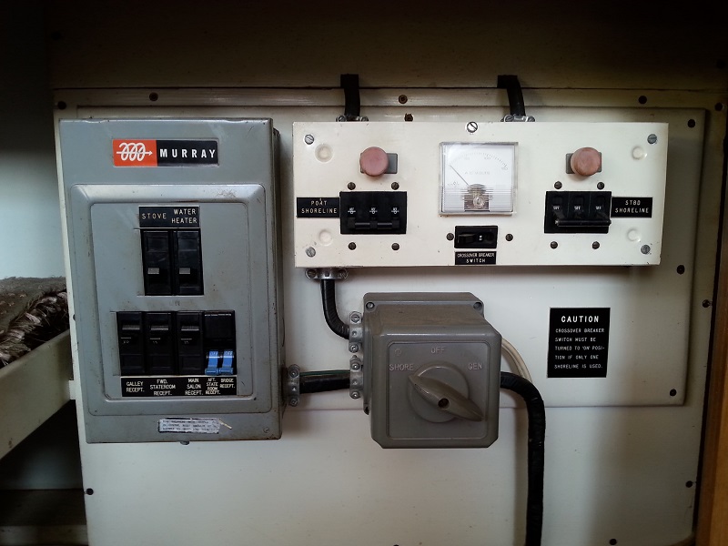

Boat is on land still. I had no problems using the shore power last year, but now the (shore breaker goes) when I try to light up either side of the main power.
Tried both sides, same result. All the breakers are off. I'm stumped.

How about some details? Single 30A? Twin 30A? 50A?
Re: Shore Power Problem
Try turning off the cross over switch ( between the 2 mains ) I assume you have twin 30 amp service .
Is the land breaker a ground interrupt type ? I have issues with them when the boats on land

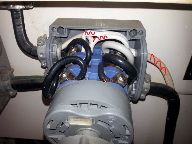

I solved the shorting problem by working backwards, first disconnected the feed wires to the panel from both side shore power feeds from the main power selector switch and powering those up one at a time. As soon as I reconnected though, the short happened again. It seems there was a feed added to the main power selector to power the battery charger below deck and the wires were shorting.
Red marks on the picture indicate the problem wires.

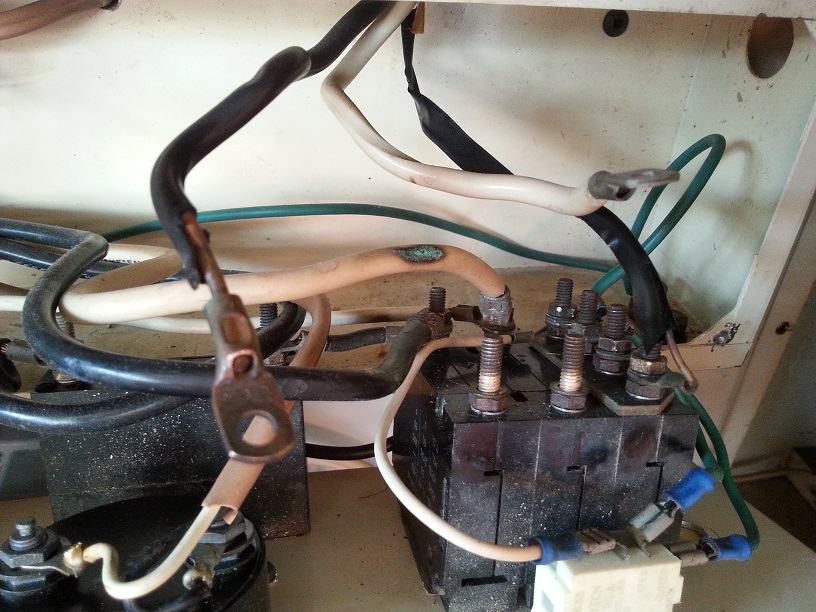

Another problem I found was some seriously loose connector terminals. These are the incoming main shore power wires with a crimped-on eye-type connector. There was some burned and crispy insulation on these wires, close to the panel. I re-crimped everything and put heat shrink over the bad bits. Could have been serious.
