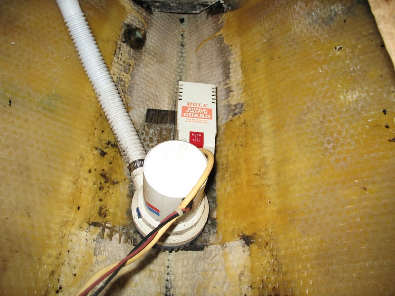

Commissionpoint wrote:Is your forward pump not flush with the bottom of the hull? Do you have a whole bunch of heavy gear stored under the cockpit deck? Not enough beer stored under the v-berth???
Because of the "V" shape forward, there is often a small pad installed like a 'bridge' (with gap under it for water to flow), to provide a flat surface to mount the pump and float switch. Because of this, the pump actually sits about an inch above the actual bottom. I have some pics of my setup, but they don't really show the pad that well. This one is probably the best I have. The edge of the pad is more visible at the top of the picture, where the un-glassed forward end of the wood is exposed...

I see your little wood 'ledge' there CM. I am sure I have something like that as well. Can't really recall off the top of my head though what exactly it looks like. I really have no problems in this department, so I generally just take a quick look at things once in awhile just to make sure nothing looks out of whack. I know Nancy had the original Lovett sent out to the factory for a rebuild, so I would imagine my setup is still close to bone stock.
