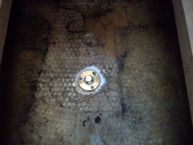

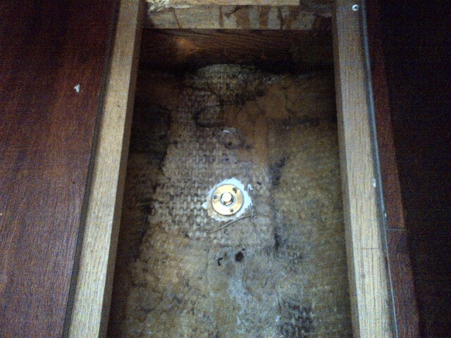

I put a brass transom drain in our boat in the center about a foot forward of the forward engine room bulkhead----- was going to put two in but could not access that area in the engine room ( too much stuff there already) ---- after asking Bob about the keel area, he said the reason they were not filled up was heating problems with that thickness of resin, so my guess is that every one of these boats will be different --- mine from the covering layer to the bottom of the hollow is about three inches at that spot----- the thing that got me interested was that there was some bleeding from the top of the keel in the spring and when I opened it up and sucked the water out that stopped right away----- amazing as it has been like this since 78----- have to go to boat and remove raw water pumps to rebuild so I will try to remember to take pics ,lol---- Mike

As promised, not much to look at but,just opened it up to drain and nothing in there----- Mike
- image.jpg (137.42 KiB) Viewed 11378 times
- image.jpg (107.78 KiB) Viewed 11378 times
