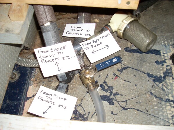

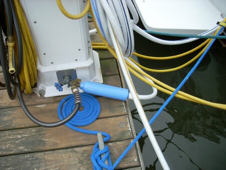

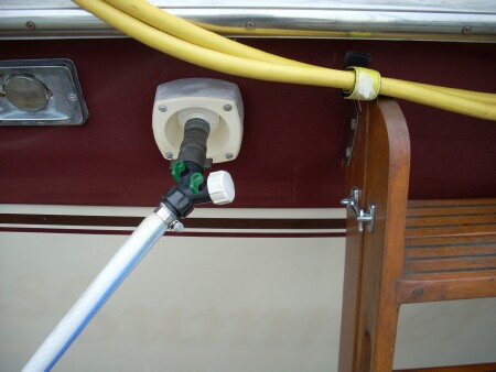

oxblood, here is my set up and pex pipe routing from the access hatch in the aft stateroom, port side, aft. i believe that this particular vessel did not come with the shore water hook up option and it was added by the previous owner. though not a standard trojan install, it works. and works well. i have also added another pressure regulator to work in conjunction with the boat side unit. i have taken the added redundancy of adding a 'Y' valve. the valve that feeds the shore system is always turned off upon leaving the boat.
let me know, as always, if i can answer any questions you may have.
aaron
water hookup boatside
water hookup 3.jpg (30.85 KiB) Viewed 13909 times
shore source with inline filtration system purchased from an rv supply store.
water hookup 2.jpg (47.3 KiB) Viewed 13909 times
placards show what and where.  ball valve, my design, allows for tank to drain into sump for winterizing.
water hookup inside best.jpg (90.41 KiB) Viewed 13909 times
