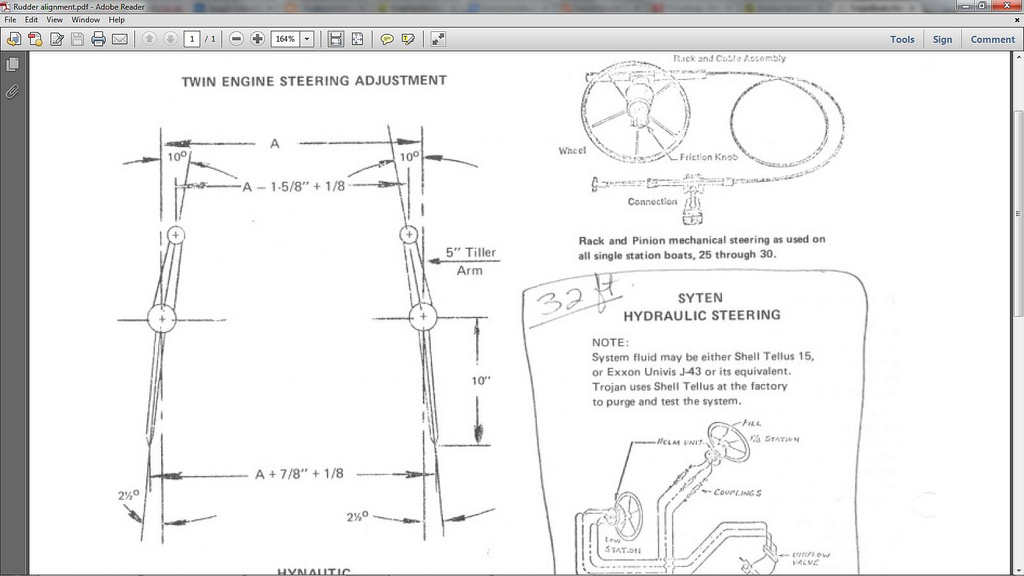

Re: questions after 2nd outing of f28 phoenix
Just measure the distance between the front of the rudders and then the back of rudders. the rear should be 7/8" farther apart (+- 1/8 ) this will give you the correct toe of approx 5 degrees total .
Ignore the tiller measurements in the photo .
This was from a post by ready123 http://www.trojanboatsforum.net/wforum/viewt ... rudder+toe
trojan rudder ajustment.jpg (123.6 KiB) Viewed 2989 times

Thanks Paul this is a big help. The speed and rpm issues I think I can solve, my bet secondaries are not opening + dirty bottom are causing.
It seems like low hydraulic oil or air in system will cause steering slack?
It could .It sure would not hurt to check it . Do you know the type of system ? If its a pressurized system check the pressure too .
