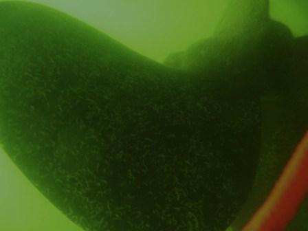

srokag44 wrote:Sure enough there were a couple barnacles on the props and a lot of white squiggly looking growth. I'll post pictures I took with my underwater camera later tonight.
same thing happened to me in 2003.
props, shafts, tabs and struts.
It happened over a period of 7 days in the warm water in the canal.
NASTY !

Here is what my props looked like:
There were a couple barnacles as well. Rudders and bottom looked similar.
