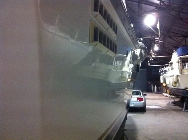

Chalky hull - I just tend to persevere with Meguiar's #44 Colour Restorer (if things get real bad .. used to use that on my dark blue Liberator), or just #45 High Gloss Polish, with a topcoat of Flagship Premium Marine Wax. My hull is 30+ years old (the last 10 under my care), and still looking pretty good! Here is a shot after haulout this year, one coat Polish applied (still need to add the wax). Note the reflection of the other boats in the hull.
Striping : I have also used Interlux Brightside Polyurethane with good results.
