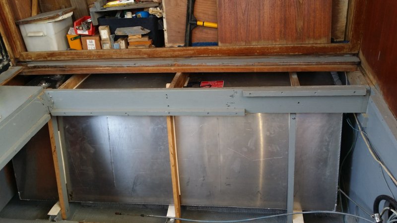

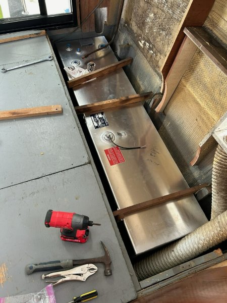

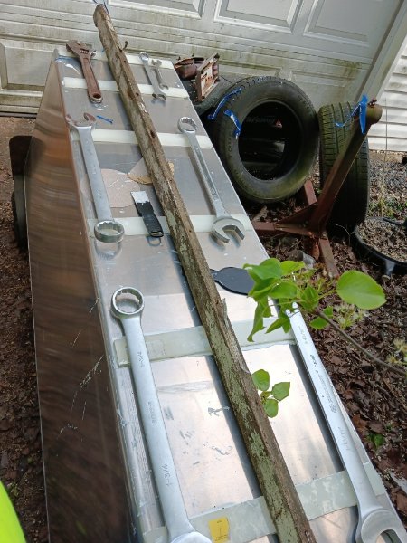

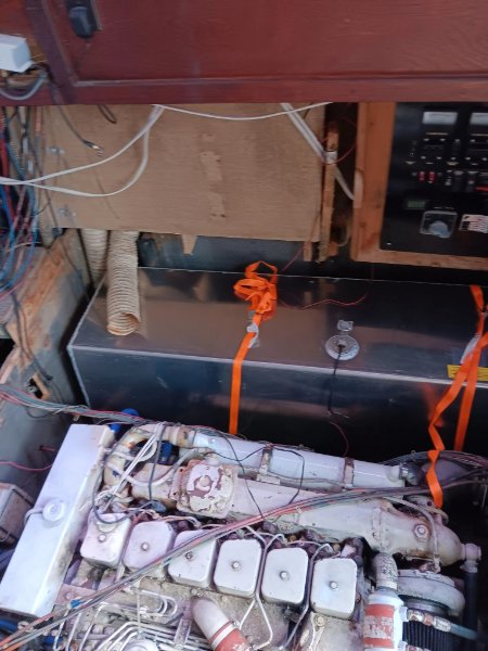

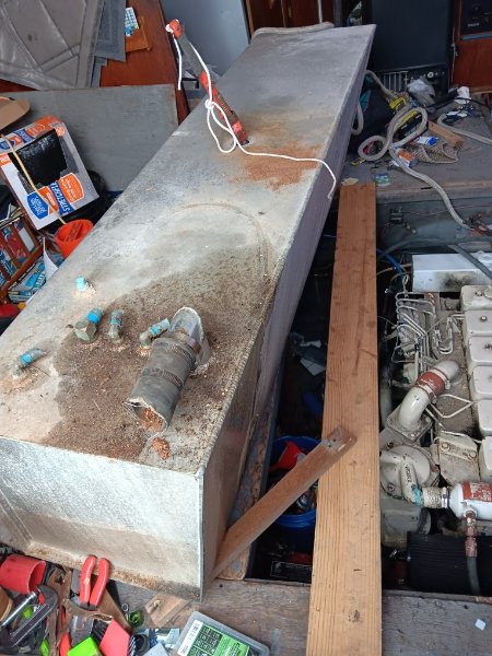

Some photos from my replacement, along with other F36s
Tank bottom.jpeg (74.14 KiB) Viewed 2495 times
New fuel tank F36.jpeg (57.97 KiB) Viewed 2495 times
old fuel tank.jpeg (80.12 KiB) Viewed 2495 times

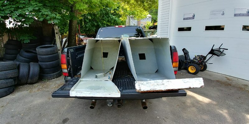

Other peoplesF36 tanks
f36 trojan tank installed.jpg (65.29 KiB) Viewed 2494 times
F36 tank jeremy.jpg (112.1 KiB) Viewed 2494 times
F36 fuel tank (Jay).jpg (85.79 KiB) Viewed 2494 times
F36 tank.jpg (80.31 KiB) Viewed 2494 times

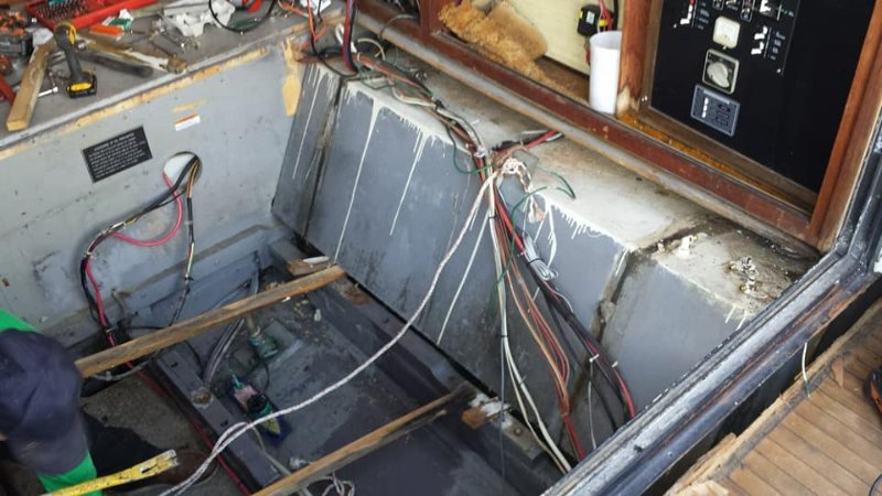

tank ( mine )
tank old.jpeg (76.49 KiB) Viewed 2494 times

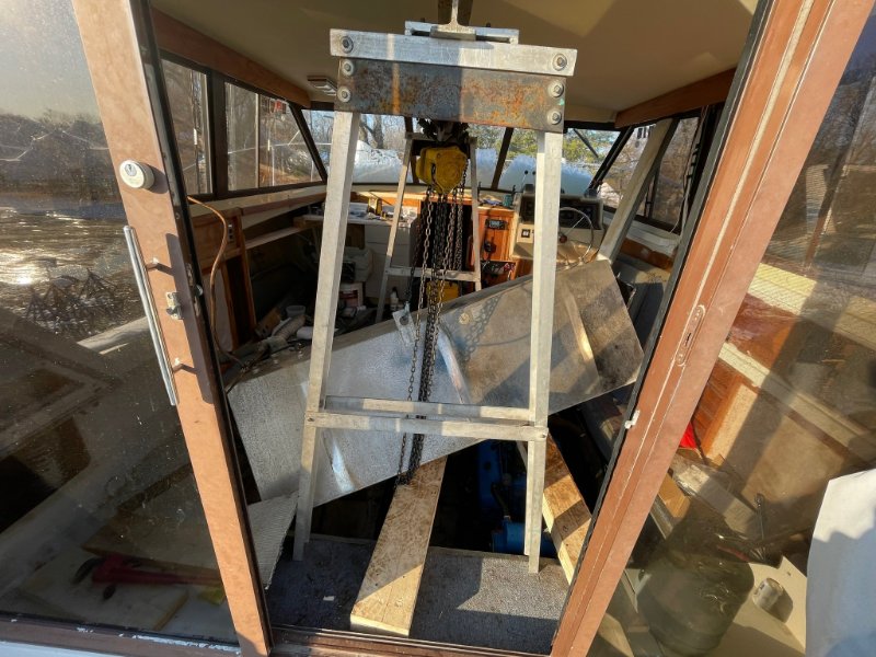

Misc.
f36 trojan tank installed.jpg (65.29 KiB) Viewed 2490 times
F36 tank.jpg (80.31 KiB) Viewed 2490 times
trojan tank by SP tims tank.jpg (67.91 KiB) Viewed 2490 times

Thank you I should be clear that the photos are from 3 or 4 different boats. The ones that looked the best were likely not mine. I got the photos from talking to one owner for advice on replacing mine. Thank you, Jay! The photos with the white engines in them are mine. And the rest are from others who consulted with me on replacing theirs. I should have more photos from at least1 more F36. I installed mine in early 2024, and I can think of 4 others that have done theirs since most were the original tanks (Mine was not) I will post more as I locate more photos. Two key takeaways: you do not have to pull the engine ( though it can make it easier and make the new tank 2" shorter in lenght, as it makes the install easier.
