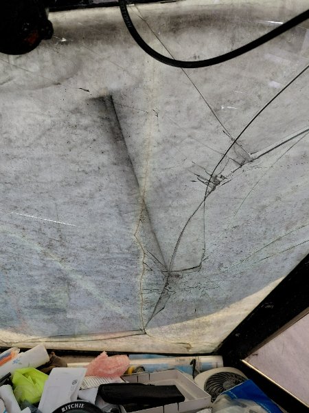

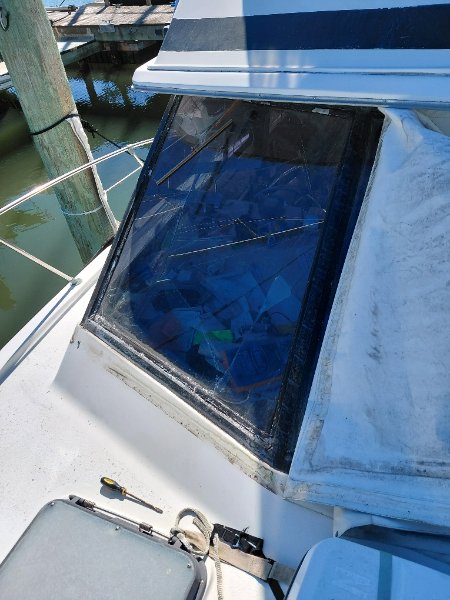

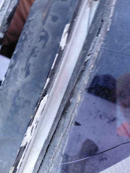

hello all.. i bought a f32 well traded ..one windshield was busted aleady. i pinched a hole in it and after a drop cloth install i cut ou the glas careful not to hit fiberglass or aluminum frame. i then removed screws and used a flat steel crowbar.. started to apply pressure at one corner and slowly work your way up. dont apply to much because you WILL bend it. apply slow but alot .it will slowly release. its held in with a soft sealant . trust me it took a bit but all is out without bending. went to commercial glass co. 150.00. gavem a pattern back in business.

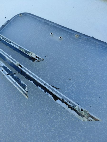

1978 F36 windshield replacement
I jusy paid to have mine replaced. I am normaly 100% DIY but with a bad shoulder and old age, felt it better to hire a pro. Here are some photos
windshield trojan.jpg (66.43 KiB) Viewed 1661 times

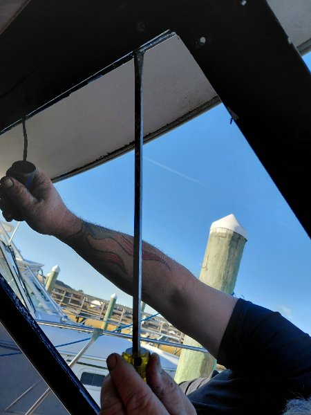

I can say it was a lot of work, I have even used the lower helm 2 times and still hate it. :D
Other side
Other side
